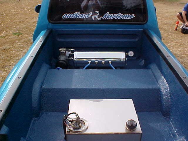

Hey man here is some of mine I want to do something different at the end of this summer though
custom mount for my compressors
custom tank mounts

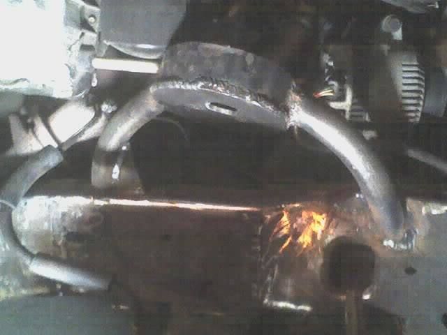

this is the side to side when I was using Currie Enterprises Johny joints

awesome rob, thanks, how big is ur fuel cell?
9

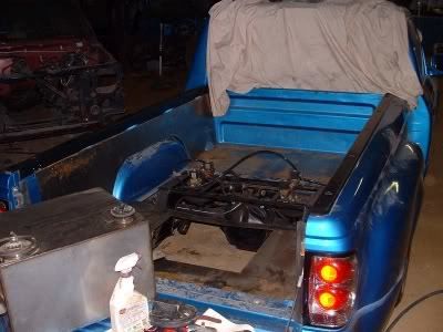

Heres a pic of my rear setup. Gravity Werx tube notch and cantilever 4 link. 15 gallon aluminum cell, Monroe shocks.
That Viair 380 is the one on the left side of the frame.

No I don't think they do. Check out Barnett Performance up in Atlanta. They are the only people locally who sell this kind of stuff. Their number is 1-800-533-1320. You can get whatever fuel cell you need, plus you will need a fuel pump. Not sure if you truck is return or returnless pump setup. If it is a return style setup, the MSD 2225 will work fine and it goes for about $80. Also, decide if you want to run rubber line or stainless steel braided off of the cell. I am running SS braided line and it requires AN fittings that are very expense ($15-20 each). The AN fittings for rubber hose are about the same price, but you dont' have to buy stainless braided line which is a royal bitch to work with.

the one on my truck is a 15 gallon, using the stock fuel pump and sender so I am still able to use the stock gas gauge

heres a pic of my bed and my fuel cell. also its the fonrt tubular brackets, but my notch is just a regular weld in notch. nothin special
