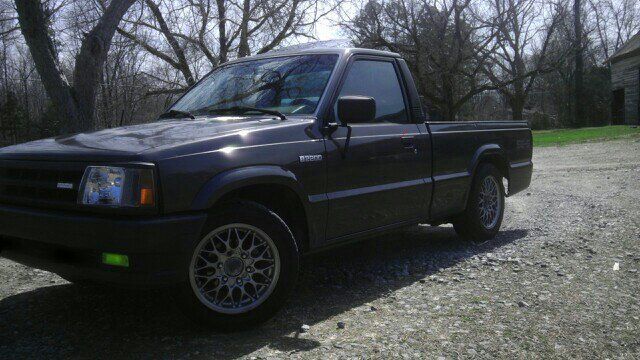

finally get around to posting a picture. Needs more low haha

looks awesome.
blowered4life's avatar
blowered4life
Thanks. What would it require to just tuck tire or almost tuck tire in the back? I dont want it super low just close the fender gap. I have 2" blocks now and don't want to go any larger on blocks if possible
anguswilly
Are you lowering that truck? If so you might want a 205/45/16 - you can run a wider tire in rear or not - but if you lower it, your max height without hitting the inner fenders is gonna be a 205 or possibly 215/45/16, personally I'd probably run a 205/40/16 in front.
chaserjohndoe's avatar
chaserjohndoe
im running 3 inch blocks and turned torsions. I have to same overall height as your tires.
Not tucking but a little lower then you. Unless you want to run bags. I don't think you will be able to tuck.
anguswilly
Unless you want huge tires, you cannot tuck the back without a c-notch.

Finally lowered my truck. Almost tucks in the back and tucks in the front. Doesn't bottom out unless a big pothole
