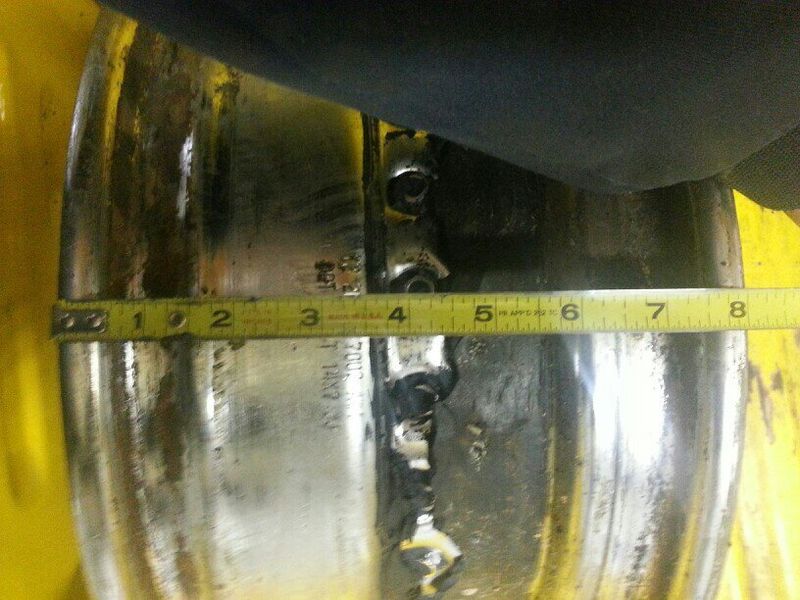

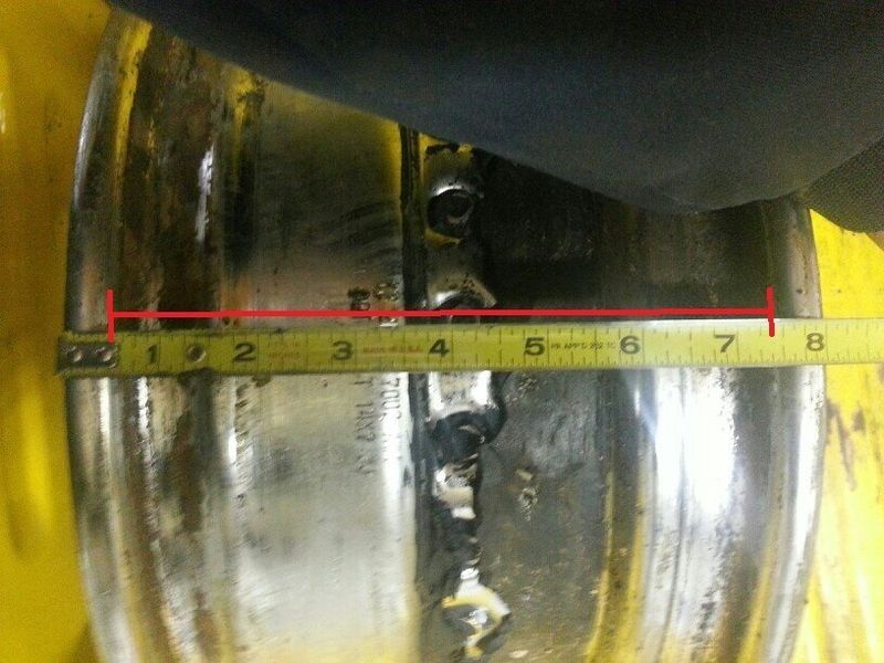

How would I measure to find if it's a 5-7 or 6-8?
Sent from my SAMSUNG-SGH-I747 using Tapatalk
mercilessltd's avatar
mercilessltd

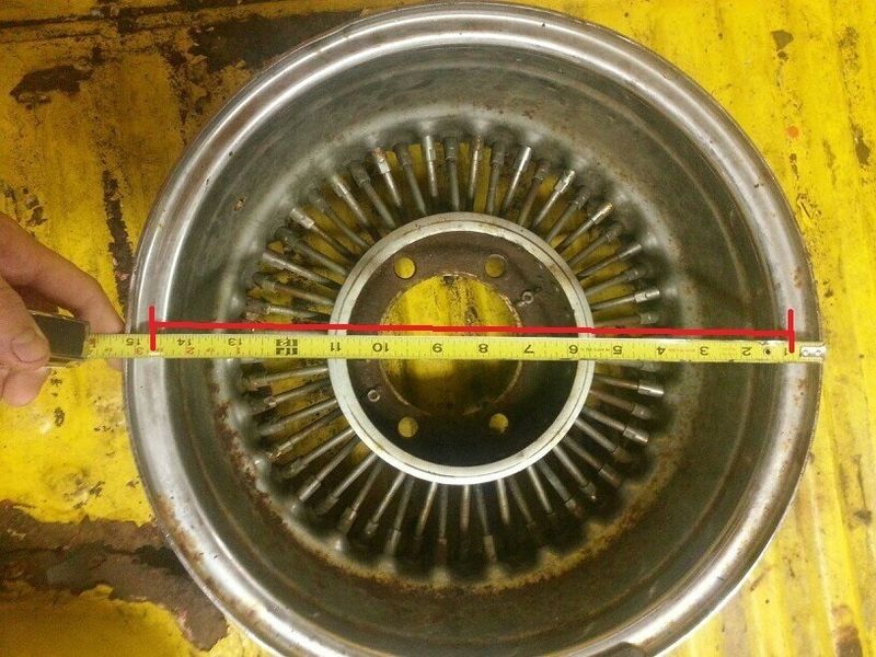

I know this isn't how you measure for tire size, but for reference.
chaserjohndoe's avatar
chaserjohndoe

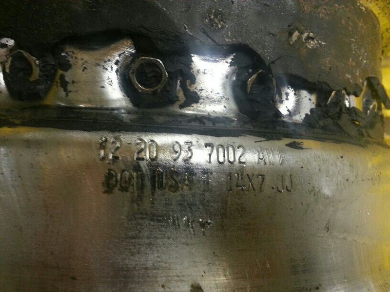

right way in red
if it is stamped 14x7 it is a 14x7

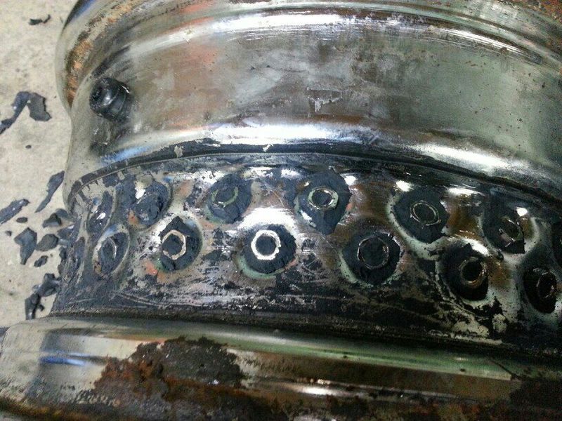

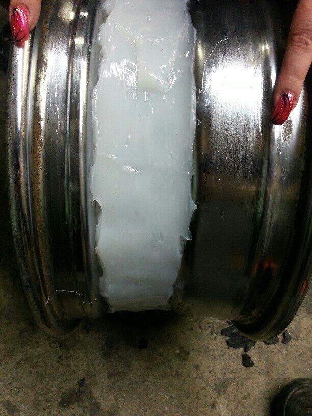

MercilessLTD- The black rubber sealant that the manufacturer puts over the spokes is really ripped. Did the tire shop do that damage to the sealant? Just an FYI but if you do get tires mounted on that wheel the spokes might leak air due to the ripped sealant, if they do leak about the only remedy is to run inner tubes on them.
mercilessltd
Fuuuuuu
mercilessltd
Dave, I'm not entirely sure if they did that or not. The rims were not leaking before (truck sat for 6 months with no leaks), so if they do now, we'll know if they messed with them.
