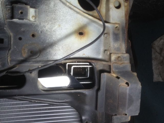

anguswilly

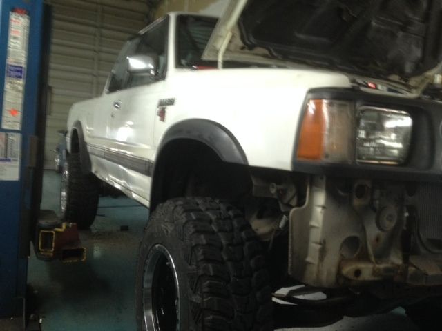

Here are pics of the front bumper issues, as you can see the bumper holes in the rad support are now blocked by the rad flanges.
chaserjohndoe's avatar
chaserjohndoe
raise the radiator.
anguswilly
Yeah but then I gotta deal with the fan shroud (if I did an electric fan it would work) or delete it which I wouldn't want.

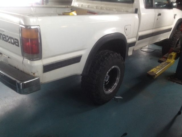

OK, so today I got pretty far along.
Finished off the bed without incident - I did have to shim a couple mounts because there was always some issue with the bed being out of level a tiny bit, no idea if that is the result of an old accident or what. I do still have to tack weld the steel spacers in and I will eventually make some gap guards to cover up the gap between the frame and bed.
I still need to figure out how to mount the front bumper, I think I can chop the mounts to clear the rad.
The rear bumper, I think I will just leave alone ( the kit does not include rear brackets and the kits that do have rear brackets do state that you cannot ever tow with the bumper) I will put a pair of the rubber delete caps that I have in there since the bumper slots are exposed now.
I do still have to mess with the shifters, the T-case shifter is just plain too short - I had to remove it and bend it in the vice over to the right a little to clear the floor and console - it will now need an extension made that kicks it back over to the left, so it clears the tranny shifter - The tranny shifter is (obviously) 3" shorter now and I think I like it like that, I only had to make a small cut in the floor to get reverse ( it did go into reverse but just barely hit the floor) I cut out the plastic plate for the boot and it seems to just clear (there is some minor rubbing within the rubber boot itself)
Still have not done the rear cab mount bolts

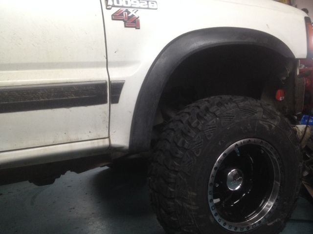

anguswilly
It's kinda strange to see the 4x4 parked back to back with my B22 - the difference in height makes them look like two completely different trucks.

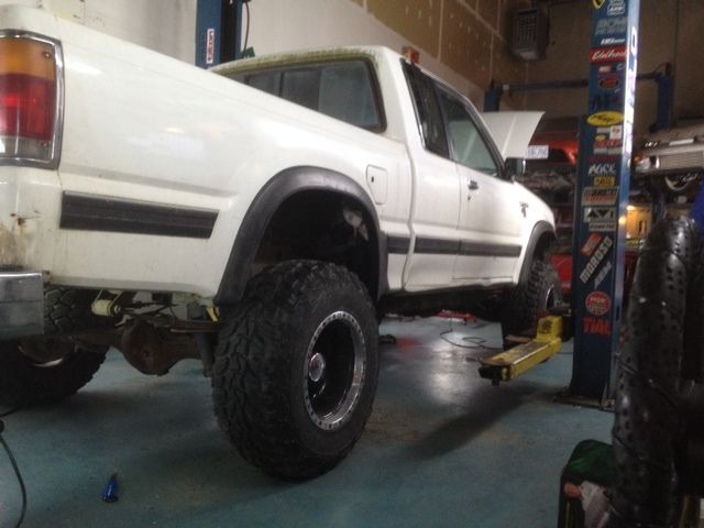

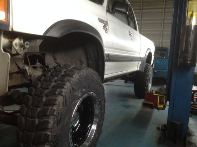

anguswilly
Fully lifted, one more day of working on it and I should be wheelin'

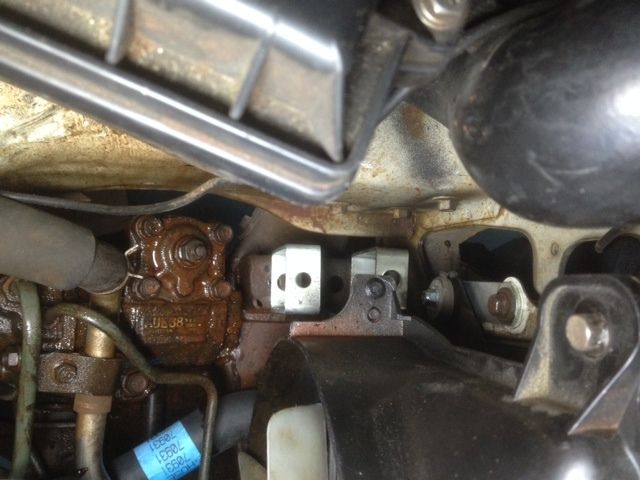

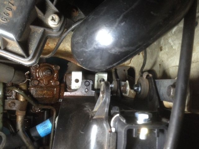

anguswilly
OK - so today after work, my only objective was to get the cab mounts all done. As I have said, I feared these rear bolts, I have heard they are a bitch and I could not find them at first
