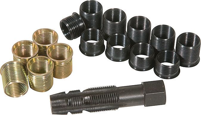

Anyway, a machine shop or even you could install a solid threaded insert to repair if such removal does damage original threads; I run such an insert on my 1835cc VW engine, and it's been fine for about 6 years now.

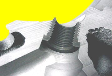

Thanks for the replys. Is there any kind of sleave in the head that the plug sits in? It looks like maybe it's sunk in to far. I posted a pic

If it runs good with it in now, no compression leakage through the plug from the porcelain being cracked after messing with it this time, I would replace the other plugs and hope that one is Titanium. "Ain't broke, don't fix it." Chances are, if you turn the plug now, the aluminum threads in the head will coming out with the plug.
When that plug starts missing, work on it, planning on possibly having to pull the head and carry to a machine shop for a boring (drilling out in a vise aligned to follow the original bored hole), since the threads may come out with the plug. They will either thread the new hole oversize hole (18 mm., I seem to recall) and screw in a heli-coil, or bore and plug it with a piece with original threads in it, like new.
Best case scenario, it comes out, threads still in the head and good, you coat the threads on the plug with never seize (a petroleum oil and graphite powder product), put it in and truck on. If this happens and there is any doubt about the threads, borrow or have a 14 mm. bottoming tap run down through the threads. Be sure NOT to cross thread it.
Good practice on aluminum head spark plugs is to always coat the threads on all the plugs with never seize, every time installed.

Depending on your mechanical ability, you can buy a helicoil kit at amazon, parts house, etc.. No doubt quicker and cheaper than pulling the head. Be sure to blow (long nozzle on air gun) as much metal out of the cylinder after you helicoil it, before putting new plug in. Remember to have the piston close to the top of stroke, but not close enough to interfere with the helicoil operation.
Another choice, line up a machine shop that you can park at, that will install a helicoil for you if the threads do come out. Next will be getting the plug out at all, as flimsy as they get when the porcelain breaks down. Then it goes to a LARGE easy out, or the machine shop drilling the spark plug out, off of the engine, of course!

Read in post 3 (2nd reply), I've used solid threaded inserts, to replace a helicoil that was professionally installed, like the inserts better.
