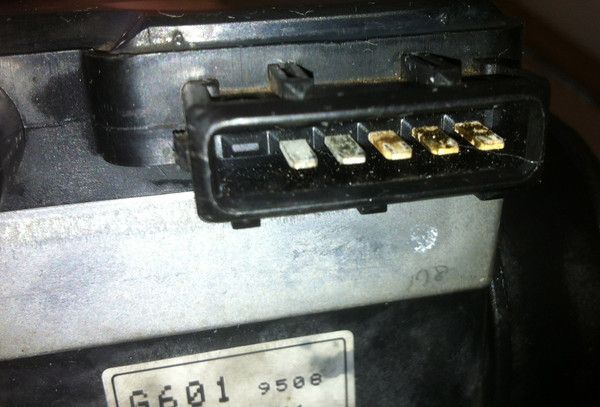

Have you checked the terminals on the MAF connecter. They are notorious for getting corrosion....

I notice it pulling away from a light the most, under power. But it doesn't just do it then, it does it in all gears(accelerating). Smooth at any other rpm. Sometimes if I let the clutch out at a much lower rpm and let it out slowly and be under load lower then 1800 or so it won't do it but its rare. I've cleaned and used dielectric grease on the maf connection as well...but I'll check again, you never know. I feel dumb on the last one I haven't tried with the truck sitting still. Doesn't seem to happen under a quarter on the temp gauge( just remembered).

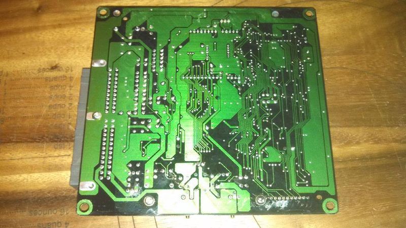

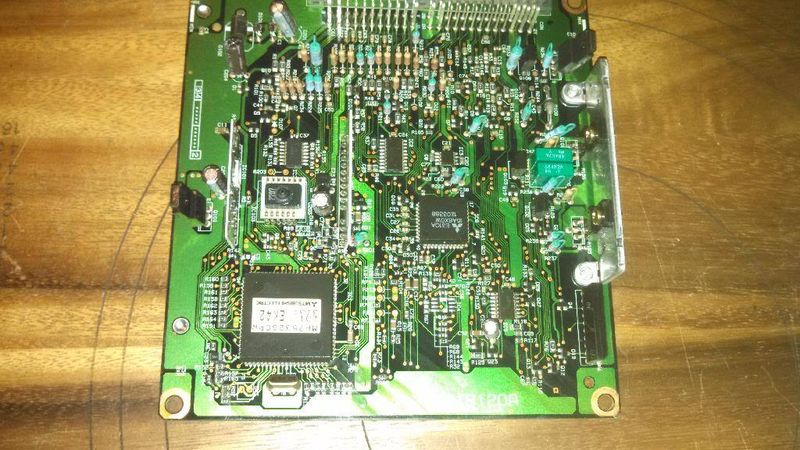

ill look into it, thanx scotch for all the help..... after checking the tps switch (good ) and cleaning the connections at the maf again just to make sure it started doing it worse...at all rpms under 2k.... so i cleaned the contacts in the cap (a little funky..only been like 1000 miles? wtf?) ripped an end of a spark plug wires double checking the gap on my plugs...(all within .02 of .44...made them all even) fixed the wire...test drove and no sputter... but it did the same thing to me last time i thought i fixed it....sunday im going to pull the ecu if i have time and put it under the magnifying glass and look for stains etc.....getting alot of small problems fixed on the way but feel like im beating my head on the wall

2003 was smack dab center in the chinese faulty capacitor plague. Open that ecm up and check for "Bulged out" or "Domed" caps.
