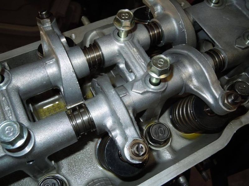

I started a thread thinking about doing some machine work to the rocker arms to allow a threaded adjuster to work.

i don't get what your saying. the LIFTERS are the same or the ROCKERS are? i'm guessing you mean the rockers are the same, if so, cant you just mount them on the G6 shaft?

The rockers are different!

The lifters may be the same, but since the B2600i is a 12 valve engine, the geometry of the rocker arms is different. The lifter end is offset from the cam lobe because the valves are in the "corners" of the combustion chamber. The rockers on the B2000/B2200 are a straight shot. Only the the B2000 uses a mechanical lifter anyway. But due to the geometry, it wouldn't fit.
See the offset on this B2600i head?

well that answers that. i thought the 2000/2200 was offset also.
