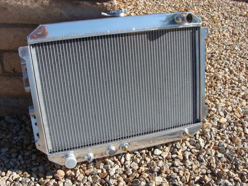

Cusser, when changing the radiator, I took out what I think is the temperature sender? Well whatever it is, the gasket is gone. does the Murray one have one? Lol
Cusser's avatar
Cusser
The Murray aluminum radiator has a plug there. It's the middle one of the five things on the bottom in this photo: From left: radiator hose fitting, drain port, port for temperature sender, then the ATF ports. This sender - I believe - is for the PTC heater under the carburetor - if you have that, have it working, or live in a quite-cold climate. So you likely don't need that.
There's also a temperature sender on the engine for the emissions system, and of course the temperature sender near the thermostat outlet for the temperature gauge in the dashboard.

Does the port for the temperature sender have a gasket with it? Or do I need to find another?
Cusser's avatar
Cusser
I'm assuming -on good faith - that there is a gasket under that plug. Because my radiator doesn't leak there.

Hmm I was wondering cuz when I follow the wire it goes to the harness i'm guessing in the front of the truck? Does it affect the temperature gauge? would it be fine to just leave the plug there on the radiator? Did you use the same plug from your old radiator? And what are the other two things for? Do I need to cap them? Or how do I go about removing them?
Cusser's avatar
Cusser
I just left the plug for that sender on the radiator, didn't touch it. That does not affect the temperature gauge, that sender is on the head, near the thermostat outlet on top/front/passenger side of the engine, near the top radiator hose, kind of hidden.
The ports on the right in the photo are for the ATF inlet and outlet for automatic transmission trucks. I just unscrewed the short tubes, didn't cap off (no need to, that was for separate cooling of the automatic transmission fluid).
