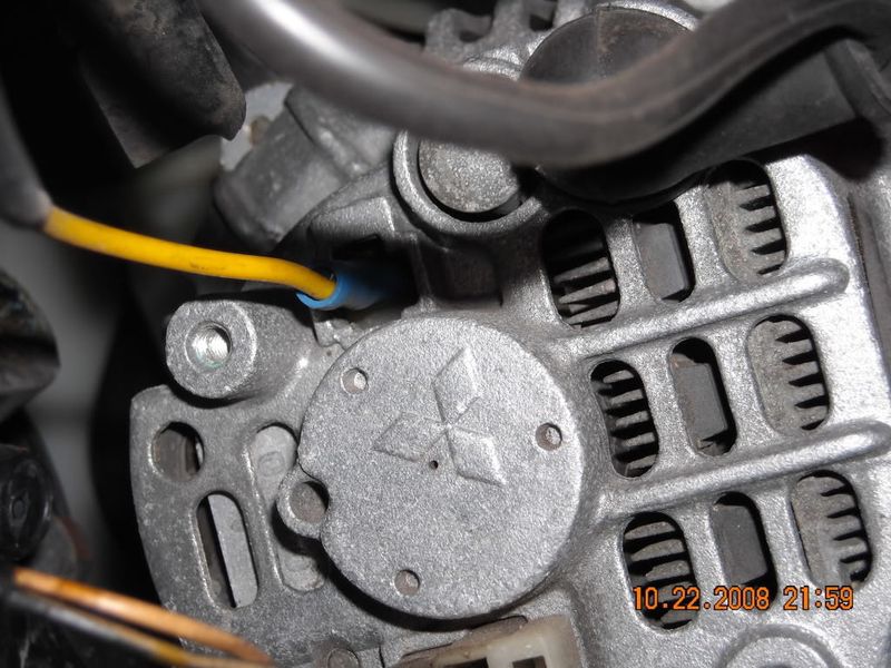

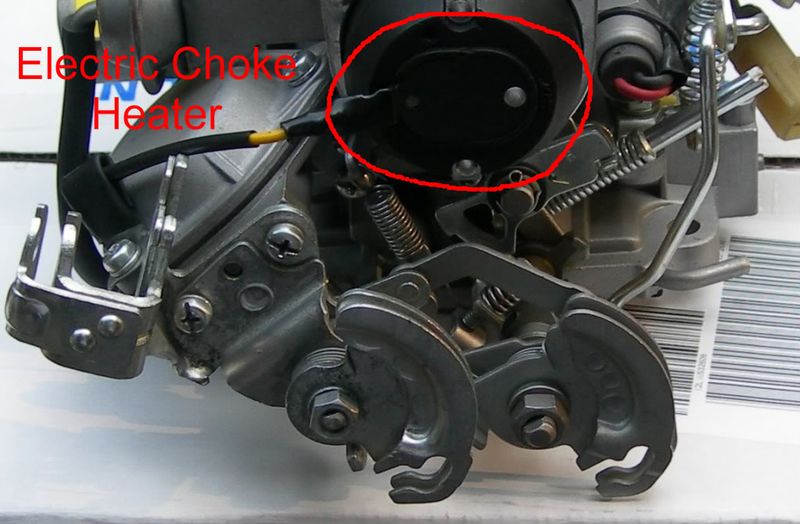

Electric choke wire plugs in right there. The bolt isn't used on mine.
rcogan
its just a female connector?
sincitylocal's avatar
sincitylocal
Yes. I believe the wire is yellow, or yellow with a black stripe.
This is not the factory connector.
rcogan
Sweet
Thanks man
