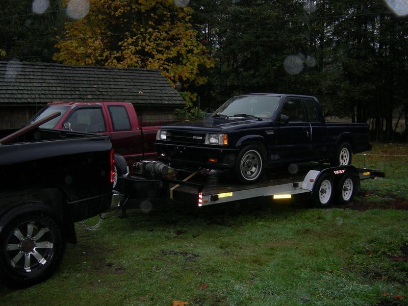

that sounds like a cracked block im looking for parts u got any pics??
tpaulh
It looks better in the pic then real life, 91 22 extcab auto
rust and dents on the body but everything else seems pretty good, good frame.
89mazdalade's avatar
89mazdalade
nice truck man if i was u and had the funds i would put a rebuilt engine in
