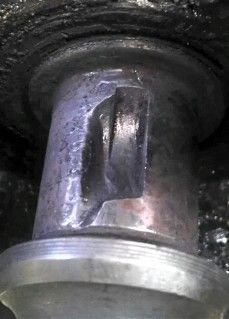

So I followed the website and still wouldn't run. I set 1 to TDC and that puts the lower timing mark about 45 degs out from where it should be and set the cam the way the website said and bam fired right up! Took for for a test drive but had to tow it home. Seems to have jumped time agian. Spits air and fuel out of the carb.
Belt looks good and everything is tight, wondering if the crank shaft is broke. Will take it all apart agian tomorrow and figure out what went wrong.
topless
Have you checked Key in crankshaft pulley?

Well the key that I could see at the time looked good, well come to find out that "key" is built into the gear....DUHHH!
So I got the gear off this morning and found the key had busted taking a part of the crank with it :/ so now I'm not sure what I want to do with it...
Put a crank in it? Slap a new key and some jb weld in it and prey? Or just sell the dang thing the way it is?
I'm ok with putting a crank in it other then the fact I don't have a stand or hoist anymore nor do I have a shop to do it in (gravel driveway and So.Oregon rain is no fun)
Any thoughts?

xxstircrazedxx
Picture of damage on crank
89mazdalade's avatar
89mazdalade
damn man that sux my truck did the same thing i bought a new crank kit all the bearings full gasket kit and i had the head re-done but stupid on my part didnt buy the rings the engine had good compression on all 4 cylinders but guess the oil rings finally crapped out every time i hit the gas it smoked so 600 in the hole for all that i decided not to keep messing with a old motor just bought one from japan engines 1300 shipped 1 year warranty free shipping on return core truck runs like a brand new 1 now
