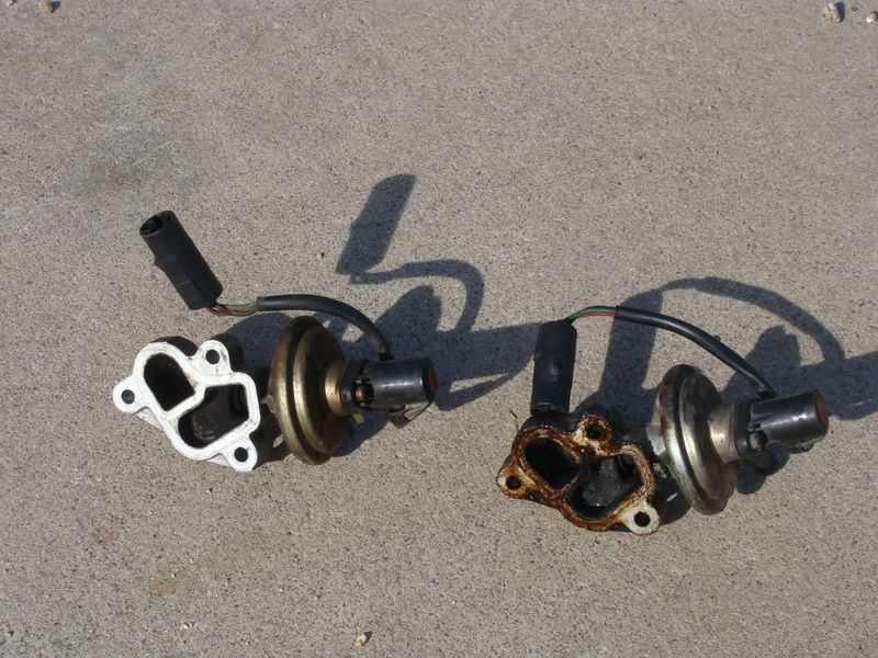

Without the EGR the NOx emissions are higher, and you'd likely fail such testing. I use Permatex Aviation on the metal EGR gasket if I re-use it.
I don't have emissions testing here, so I have two EGR valves, cleaned out, both open when vacuum is applied, and both close when vacuum is released, would let go cheap.
