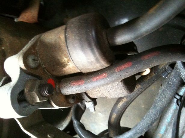

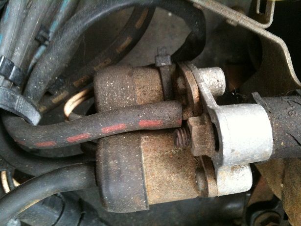

Hey I'm new here, I just bought a 91 b2200 fuel injected but it runs a little rough and jitters at low rpm and idles a little high.
I've been putting a little money and parts into it (nothing major) and it has a check engine light on...
A mechanic told me this part (pictured) was the problem and I needed to replace it. He said the OBD1 reader read Error 44 or 45 (i dont remember lol, i think he said 45) and told me it was this part that i needed to replace and called it a "Vacuum Solenoid" but no auto parts store can find it or even knows the name of it.... nor can i find it anywhere online? I don't know if the mechanic was wrong or if I just need to try and find one in a local junk yard / wrecking yard.. help please!!!!! appreciate it and thank you!

It's the "duty solenoid valve" used to control the EGR.
E
emjay
I was looking at this trying to identify that part for you. This chart is for a carb'd model but I think that the part is still the same. I think that it is the duty solenoid valve.
