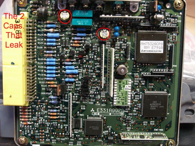

The EFI B2600i trucks have problems with leaking capacitors (2 of them) on the ECU board. If I'm not mistaken, the ECM for the injected 2.2 is nearly the same as the one for the injected 2.6, so that would mean they would have the same issues.
You can pull the computer, remove the cover and look at the board inside of it. If there is corrosion around the two capacitors (below them as it is mounted in the truck) then they are leaking and etching the board and the components.
One of the telltale signs for a bad computer in the 2.6 is how the engine stumbles as you depress the accelerator.
It might be worth taking a couple of minutes and looking at it.
Here are the 2 capacitors that leak on the B2600i truck computer.

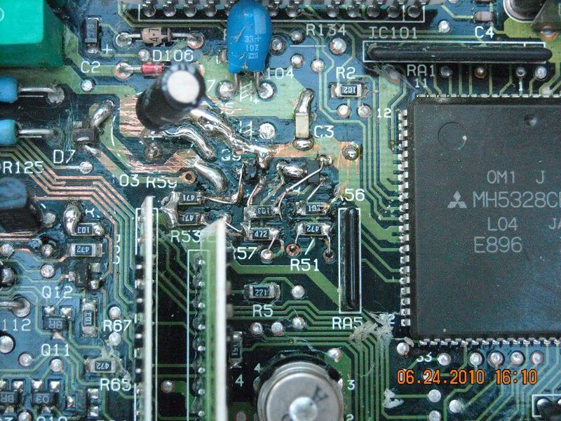

There are places like AvPro that will repair them for you if you find that yours is bad........this next pic shows a "repaired" computer that probably should have been trashed IMO, as you can see, they did a rough job on it also!

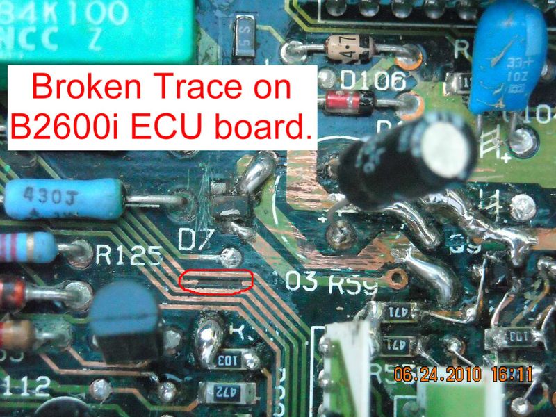

Here you can see if it goes too long with this acid from the leaking capacitors sitting on the board, it can eat the traces up on the board as well.
