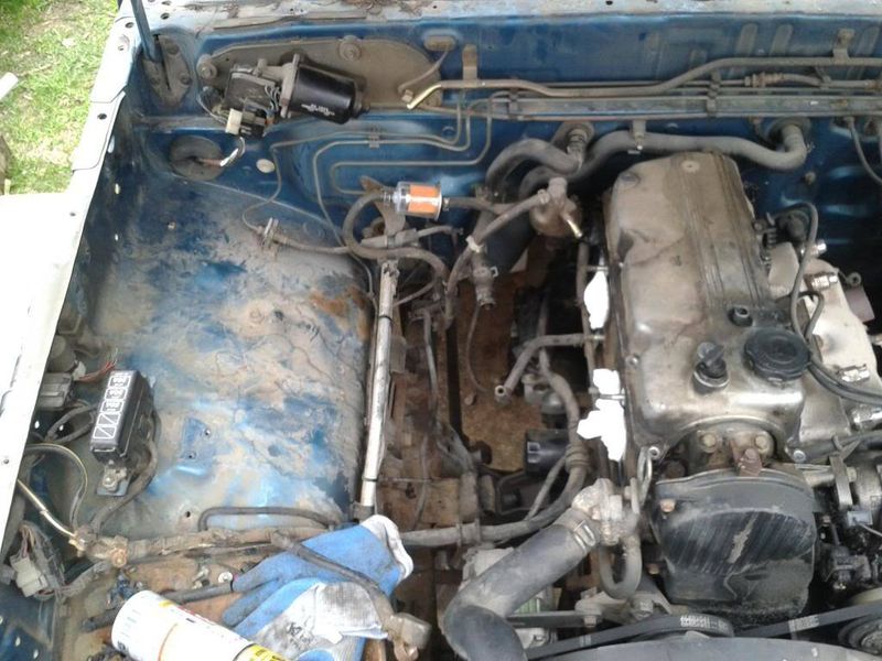

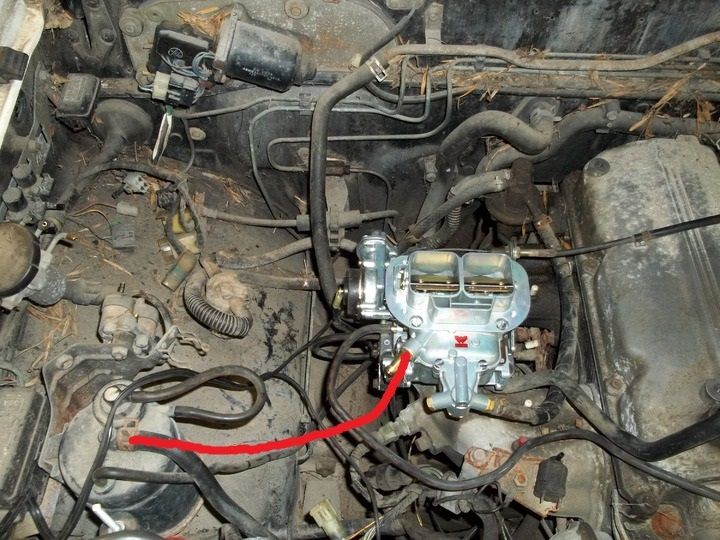

Here's my set up pre-wire tuck. and one post wire tuck. 2 different trucks thou.
the red line indicates where the canister hooks to the carb. If you are running the canister.
On the blue truck I will be putting the canister on the firewall down low.
