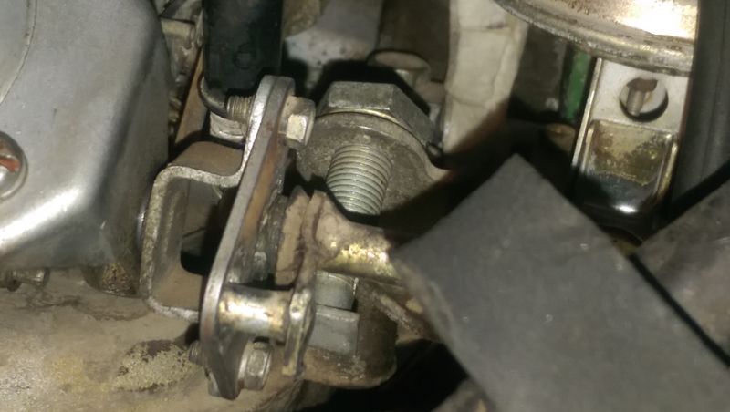

behind the carb there is a bolt, on mine its a huge bolt and you should be able to screw it one way or the other and it will hit that throttle plate, i will try to get a pic of mine but i think my bolt isnt even the right bolt haha.
andrewoot's avatar
andrewoot
this is it, best pic i could get this soon

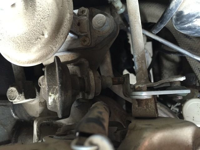

So I had a few mins to work on the B2K the other day, I couldn't find the bolt pictured, but I did find this.
I pulled that little plunger out a bit and she fired right up and idled great, for a short time until I actually drove around a bit. Then it was back to the same old issue. I assume this is some type of idle control plunger of some type. Thinking it may need replacement?

No, that's not it! That's your dashpot... it's used to dampen the throttle when closing.
Your having adjusted it should do the job, but there is supposed to be a screw dedicated for said adjustment.
leitung
Problem is that pulling it out didnt fix it. It fixed it for a few mins until the plunger just went back too far to keep it running. The other picture looks like someone just replaced the dashpot with a bolt.

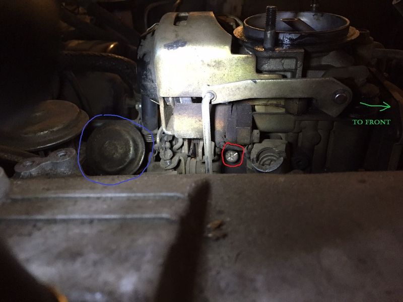

Well I spent the day getting the "B" back running, I finally found the idle speed screw, I have attached a photo of the screw location with the hope of helping a fellow 84 B2000 owner fix his/hers some day.
The red circle is your idle speed, after some adjustment I got it to hold an idle. I still have a tune up to do with this thing, I may replace the EGR valve here next along with the fuel filter.
The blue circle is the back side of your dashpot, I also made some adjustment to that as well. I am standing on the passenger side of the pickup in this photo.
Well onward to the next tune up stage...
