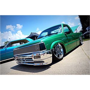

so the other day on my way to school my truck died three times. everytime it died, it started right back up. The next morning, it died again one time and again, started right back up. today, it died again and started back up no problem. It usually dies while im stopped or idling or at low speeds. but it did die once while i was driving at about 40. Does this sound like a fuel pump issue?
