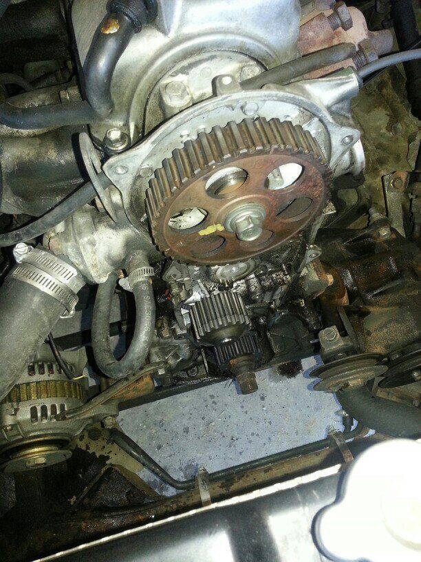

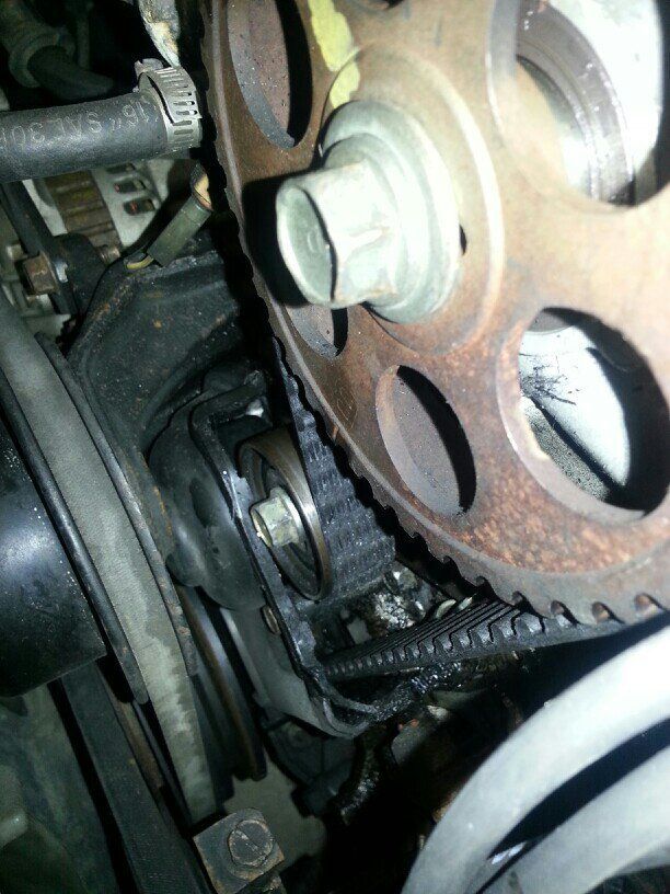

I pulled a distributor from a 2.2 today, but when I aligned the timing to TDC, the distributor aligned correctly like the teeth were tight.
I then took off the valve cover and turned it a few times. It would turn the cam a few times... then it stopped. The timing belt wasn't moving. Here's why:

Cusser's avatar
Cusser
Ahh - toothless !!!

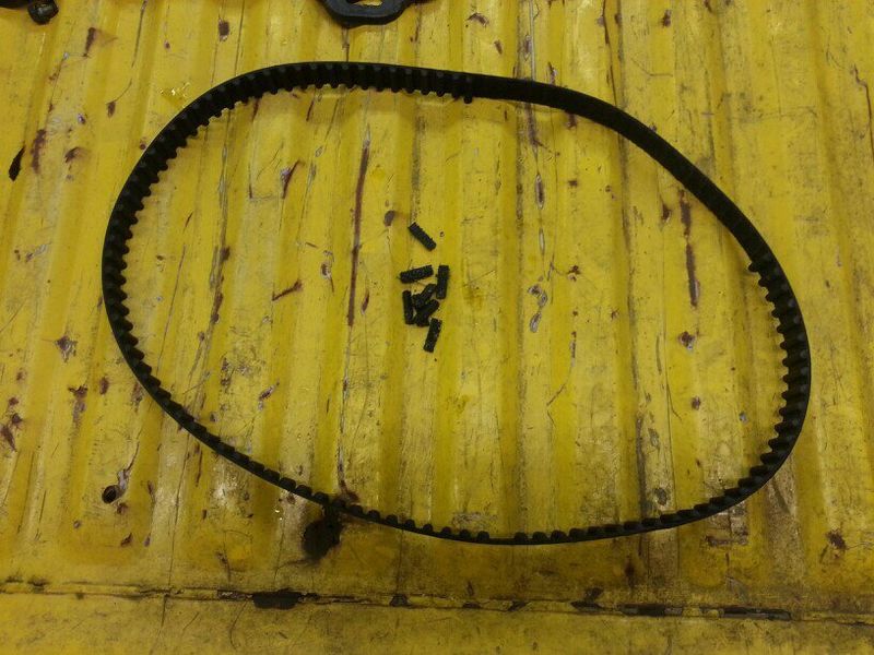

mercilessltd's avatar
mercilessltd
Nice! Sounds like I'm in the wrong business.
Here's the current situation. Waiting on delivery of the belt to my local O'Reilly.

mazdatweaker_2
Glad you figured this one out with a little prompting. This is also a really good reason to be glad these motors are non-interference engines, because otherwise you would be looking for a replacement head about now.
