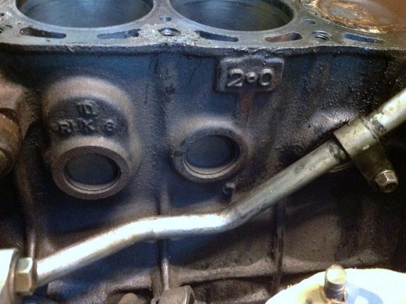

I pulled it around and filled it full of water and started it. its leaking up behind the exhaust. I cant really see where, but I'm hoping it is a freeze plug. Any idea where I can find a diagram of where the freeze plugs are located?
mazdatweaker_2
Try going to the dealership. They might run you off a copy of a block diagram.
mazdatweaker_2
I don't know if your engine is water routed the same way the later 2.0 liter motors are, but there is a metal bypass hose that carries water from the water pump around the back of the block. That line is bolted to the block under the exhaust and maybe it has developed a stress (vibration) crack.
