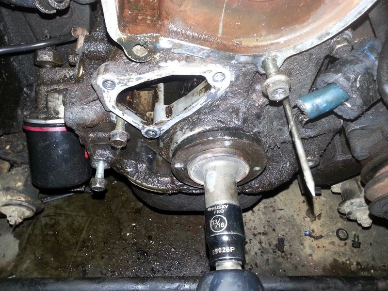

Ok, so I am attempting to remove my timing cover but am having trouble getting the balancer of. Chiltons says I haave to remove the big bolt in the middle to get it off and it aint budging. I have had the impact on it for a while now and its not moving. I assume its threaded in the normal direction. Here is a pic of it.

Electric, or pneumatic impact?

pnumatic

I am in the middle of replacing a blown head gasket with the help of a friend and we had the same problem. Tried and tried Tuesday with no luck and then when I got over to his house yesterday morning he had it off. Asked him how and he said that he talked to a mechanic friend and he said to just make sure the socket was completely on it and that it would take in the neighborhood of 40# of pressure. I'm sure this doesn't help any but it does come off......eventually.

40 pounds is like nothing.
I'm sure it doesnt help that it has been on there for 31 years. and if your just replacing a head gasket you really didnt need to go thorugh it if you marked the can sprocket and chain.
first time I had it back together it fired right up, but I had a bad head gasket and had to do it again, at which time I didnt mark everything and lost track of the timing
I'll keep at it and hope it breaks soon.

Squirt some ATF in the air nipple on your gun. About an ounce if you can. When you pull the trigger, it will become hydraulic for a few hammer strikes. If it doesn't break it loose then, you'll have to apply some heat to the crank, in order to help.
I worked as a mechanic for nearly 20 years. I never regulated my impact for a bolt this big. I used 100 to 120 psi most of the time.

40# didn't seem like to much either, but have never owned air tools so had no clue. That is just what my friend that is helping me told me. Maybe he knew SinCity's trick and didn't tell me...LOL

I think maybe he said 140 PSI air pressure? you need a good impact, mine does 780 ft. lb. and I still need multiple attempts sometimes with crank pulleys - you also need a good impact socket and you'll need to just keep hitting it sometimes for a long time.
