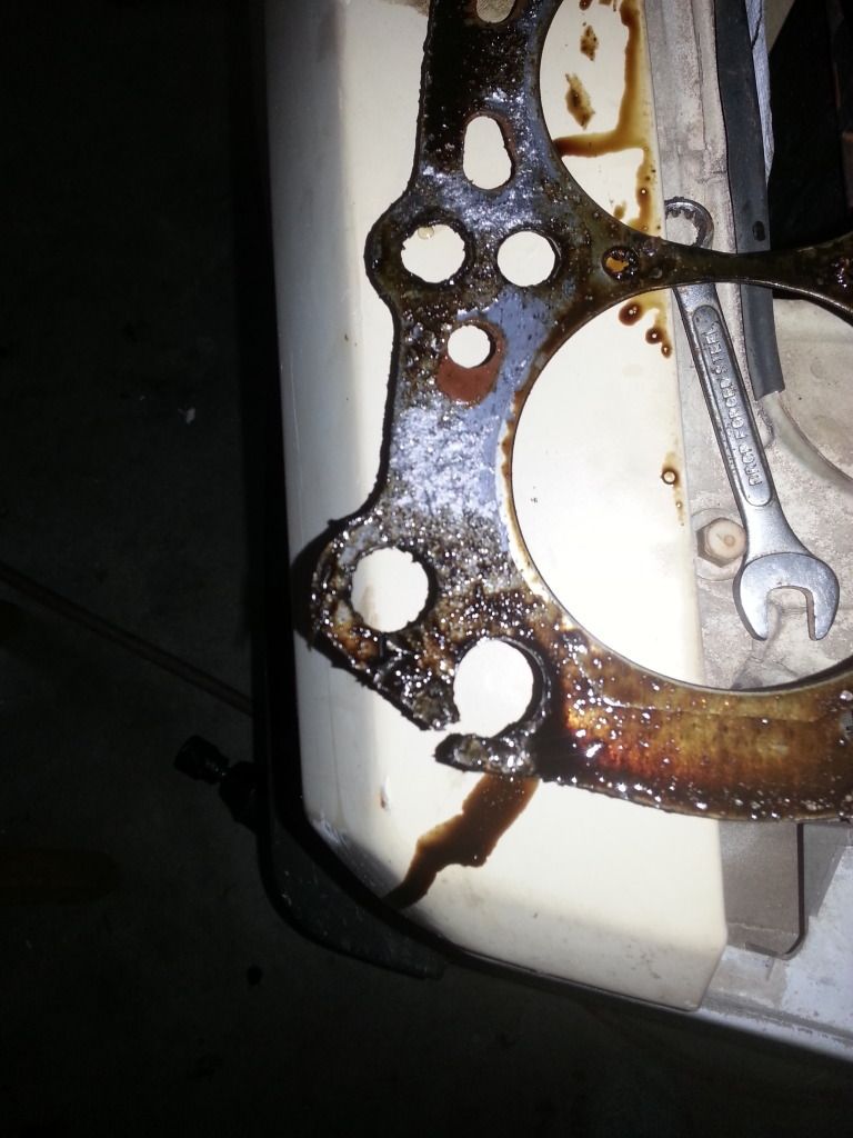

Think I found it
Cusser's avatar
Cusser
Great photo though.
