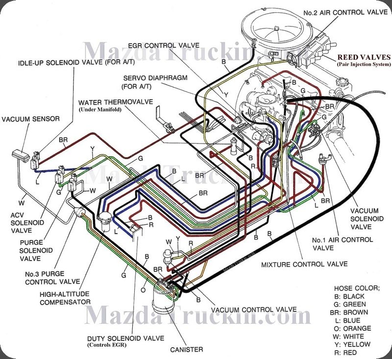

Does anyone have an exploded view diagram of this carb with a parts list?
zackarytucker87's avatar
zackarytucker87
Does this help?
