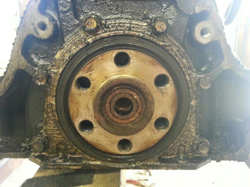

Thanks. Forgot to mention: engine is out so that isn't an issue. Do you know if I need/should replace the half moon thing? What exactly is it? Another seal of some sort?

I'm racking my brain on the "half moon thing"...got a pic?
The only thing I can think of that you may be talking about is the rear cam seal....but its more of a "full moon thing"...

See the six bolt pattern that's a half moon looking shape going around the top of the rear main seal?

Oh, the back of the engine, not the front, LOL!
I don't normally remove that, but I have before. You can pull the rear main without pulling the "half moon thing".
If you do need to remove it though, like if you're going to pull the crank out, you can just use silicone gasket maker, kind of like you do on the oil pan. I usually use the black silicone gasket sealer from NAPA.
