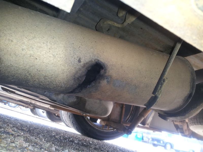

While I was there though I found this!
Could this be my issue maybe?

it didn't transfer the video, just the pic, but loose exhaust parts will rattle and bang around, mine did for a while. that's a big hole, maybe u got a rock or somthin in the muffler jingling around. lol

Idk how to post up video from photo bucket. Once I figure that out then I'll repost it. But the more I think about it the more I think that it's exhaust related.

I hope it's not rod bearings but on a positive note it went away this afternoon. (today's been the first warm day in a long time!) this afternoon I drove into work for a meeting and it didn't make any unusual noises. Just the typical valve train noises. I'm starting to lean more towards exhaust noise because I looked under the truck again and the old (broken) hanger finally fell off! Maybe that was my issue? Idk though. The knocking/rattling noise doesn't sound like any rod knock I've heard before and it isn't audible from inside the cab only when I'm outside and when I have the windows down and at a red light.
