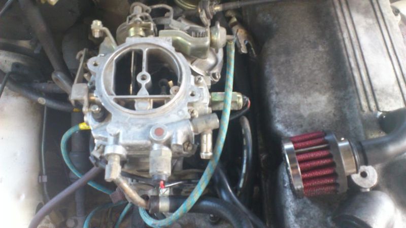

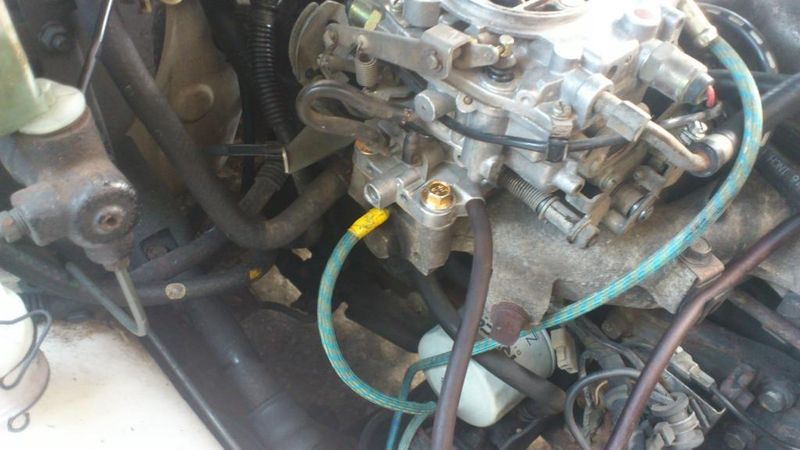

Hey guys I brought a b2000 a few months ago and it came with a 32/36 Weber Fitted to it. Iv pulled it off and found a standard carb for it. I was putting it on today and cant find where 2 outlets or inlet go to can you help. iv gone through the hyanes manual but cant see anything in there.
1: is the big nipple in the middle of the photo on the right hand side of the carb.
2: is the vacumm line that iv put on (bluey green long hose with the yellow tape on it)
thanks guys

The big one goes to the charcoal canister and the other one gets tee'd and goes to 2 sensors.
karlb
Dont have a charcoal canister. Is this an older model carb? or the right one for a 89 B2000?
macka65
probs an older model carb i would guess, i have a charcoal canister on mine but its not needed so you can prob just plug that one off see how it runs without it.
