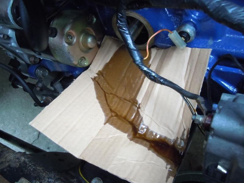

hey mazda friends.. (does a scared look) i found my oil leak that i been hunting down for weeks. it only leaks if i turn the car on.. if the car is off it stops leaking it is a screw with a tiny hole in it.. and there was a wire(If it was the right one to go on it) which was extreme skinny on it. what it could possible be
doolie92
plug it might go to your oil pressure sensor.I think it is your oil pressure sensor.
tucknrimmaz's avatar
tucknrimmaz
doolie92 is right.

your right bro.. after doing hours of search i came across this video
even though its a bike... it looks almost the same as mine.. the plug of course

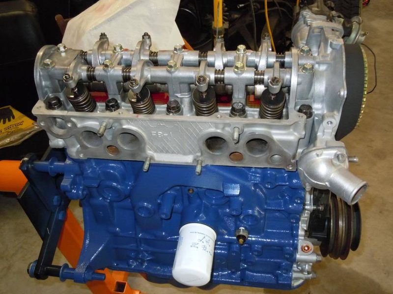

axel breaker earl's avatar
axel breaker earl
Yep.....the oil pressure sending unit. I tell others to look closely at that when they have an oil leak that they can't find. Typically when the engine is running, the oil can actually spray out from around the crimped-on metal housing, or from around the tab that the wire connector plugs onto........it can be hard to see if it is a very fine misty spray, other than the fact that oil gets everywhere! Here is a cleaner picture of the oil sender.
