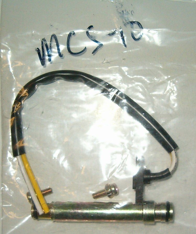

here is the air/fuel solenoid this can make the carb run rich and may be the issue your having.You said you rebuilt the carb but this part is what fails.Also I would recommend if you have not already remove your egr valve and clean it out!!!! has three 10 mm bolts,one vac line,one electrical conn, just make sure the metal pintal moves freely back and forth and use carb cleaner to clean it and NOTE the position of the gasket on it when you remove it and reinstall exact.If this is gooked up it will cause drama like it is the carb,and how are your charge air pipe filters?That aluminum housing on the air cleaner has 3 filters inside that restrict air flow if all gummed up.I am leaning the part above or egr unless you did the egr clean up already.I got this part from " target="_blank for 136.00.I may be over thinking this idk just sharing some thoughts
