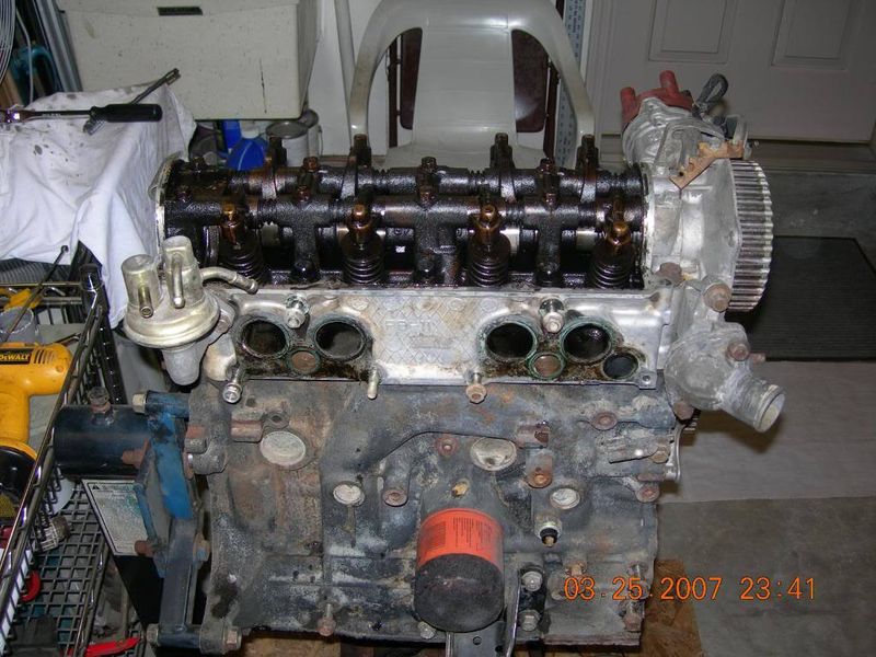

Hydraulic rocker arms do not have the adjuster nut on the top of them.....like so.....

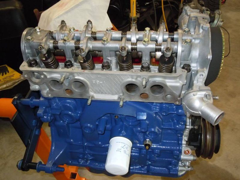

Mechanical rocker arms do.....like so....

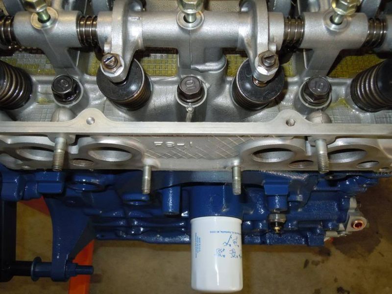

Closer pic of the mech. type.

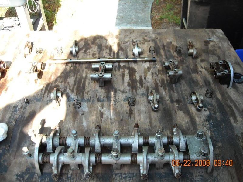

Here I was swapping out some hyd. rockers for the mech. ones........you may need to click on the pic to zoom in on it and see it better.
