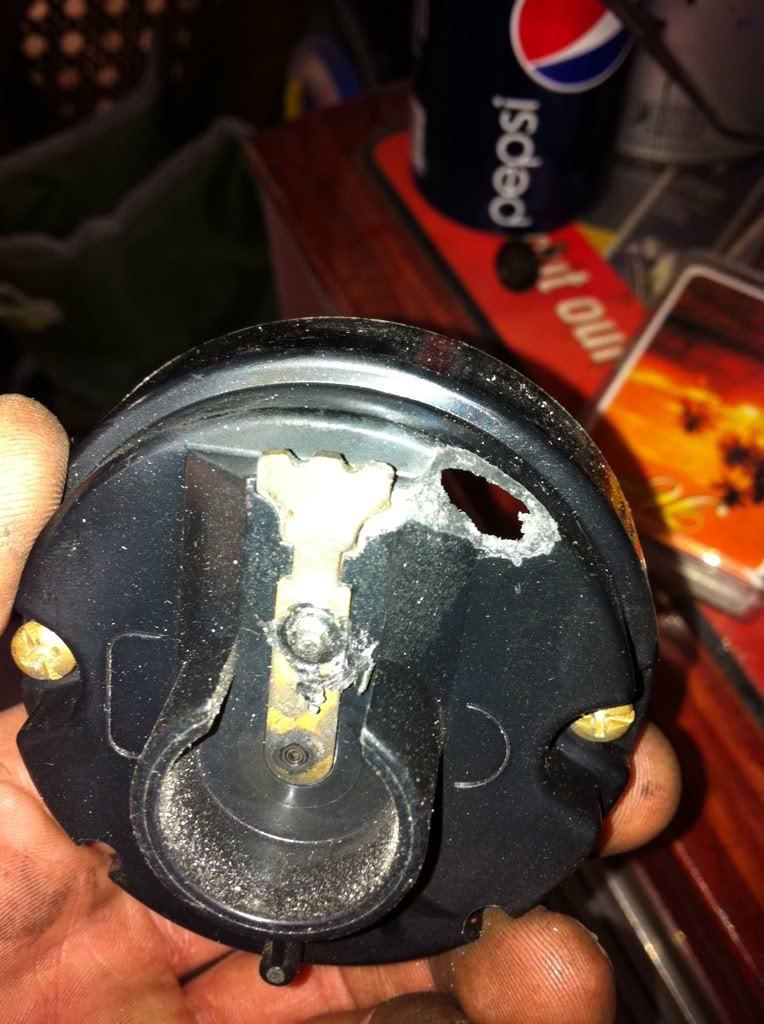

also i pulled mine apart this weekend and found a couple of things....
rotor button.....

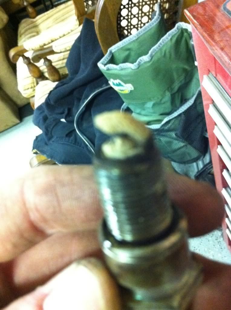

plugs all basically looked like this... this truck has 88k miles on it
troylong45
Wow that's nasty lookin lol do u get good gas on a webber I get like 18 mpg right now I smell like gas out the ass befor it warms up u can smell it and see tons of smoke
