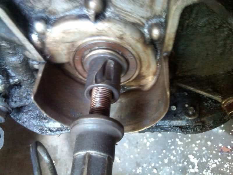

well no luck....had an ASE cert guy come out here, who's family friend and we proceeded to "start" the timing process all over again...well it kept jumping teeth after every 2nd rotation of the bottom crank....so we took the harmonic balancer off, and then proceeded to take off the bottom crank...well got the bolt off easily with an impact wrench and loads of PB Blaster.
BUT as we tried using a puller on the crank, it just would not budge...he looked at me and said you're F$#@-ed.. After about 20 mins of play we got er off...and heres the Aftermath of my wobbling/no tension issue and why the truck (since i bought it) has always ran rough
the major chip in the Key way
here's why it wouldnt come off and the pieces of the broken key

mine just did the same thing and i fixed it cheap if you want to know how let me know
your gonna need to replace the crank to do it right
or weld a ne key in the crank and grind the welds until the balancer will fit back on ..make sure to weld in where the chip is then grind it too
hocbj23
If u or a buddy is good and I do mean good with a welder,u can fill in the "wallowed out" place on the crank snout until the Woodruff key will fit snugly in place.Mine was repaired 30000 miles ago(engine IN the truck) and it still runs fine.Beats replacing a crank. By the way,2200 Maz motors are known for wallowing out the keyway so yours is nothing new.bj
