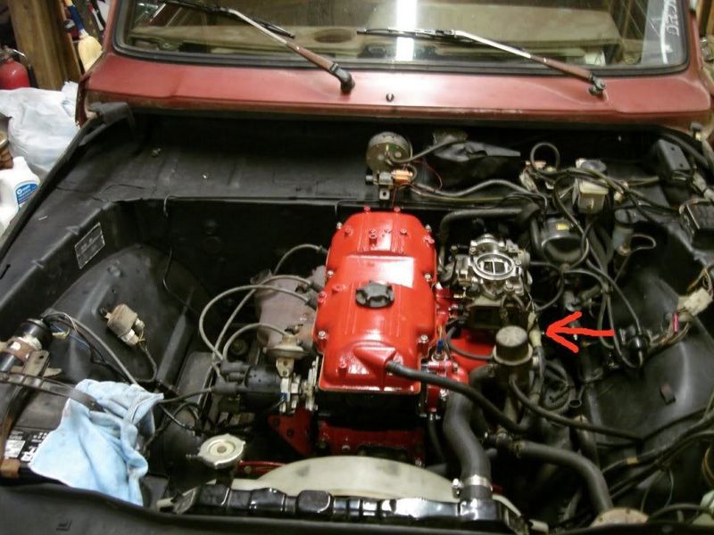

There's a hose that comes from the valve cover on the front that goes into the side of the carb/intake manifold. It's usually big and white.
Marked with the arrow

that doesnt look like the pcv valve i bought while i was at work yesterday lmao

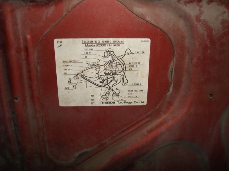

Haha thats it. It should be marked on the vacuum diagram under the hood too. But that's it.

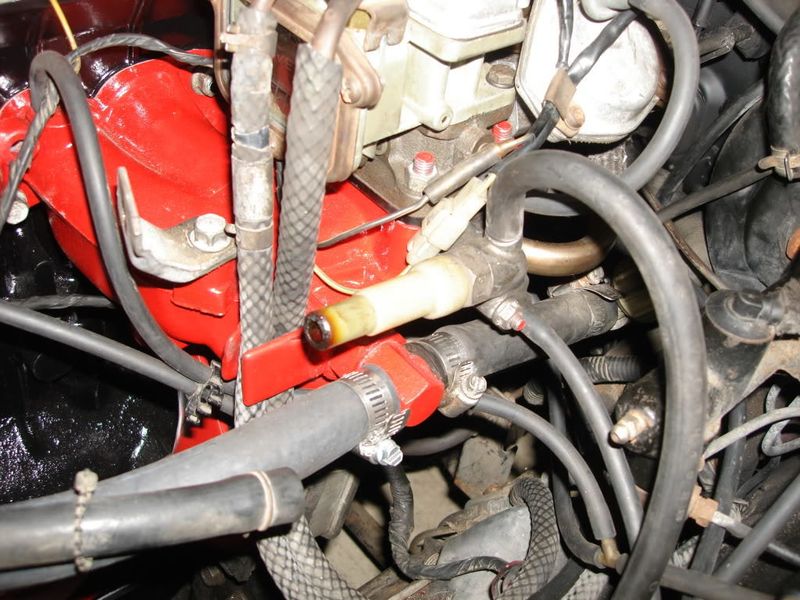

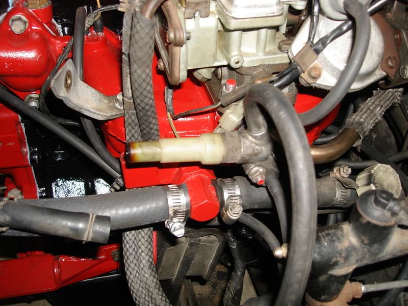

The metal cup thing is an emission thing. Came on california trucks. That yellowish white thing is my PCV valve.

Mine looks like that, threaded on one side, the only difference is my PCV has the male end for the hose.
