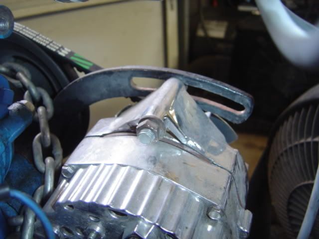

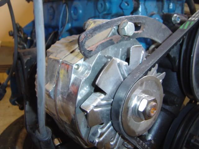

it's pretty easy man. i just had to flip the alternator upside down from the way it originally sits because of the way the mounts are. i will go take a pic right now while i have the engine out.
maztang (ryan)'s avatar
maztang (ryan)
here it is installed
here is originally the bottom mount that i had to use as the top mount

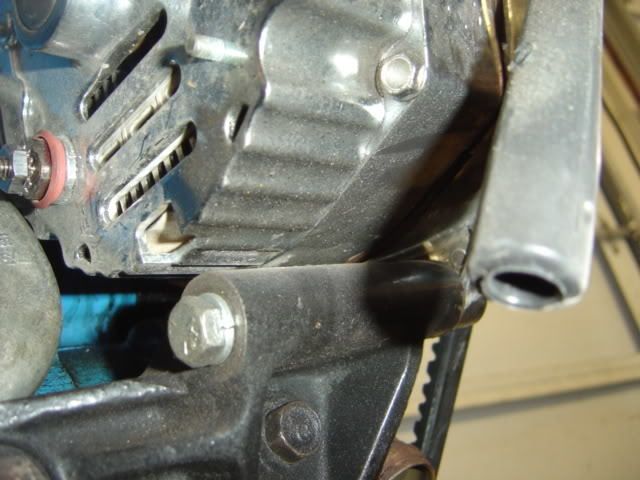

and here is the bottom
everything else is pretty easy. you will just connect the white wire with the red stripe to the hot on the back of the alternator and don't worry about the plug.

For all of you guys that are simply flipping the alt over like you have Ryan need to make some kind of brace for the back lower side of the alt. The little tab that is now on the bottom is not thick enough to support the alt weight and tension on it and will eventually break it off. Trust me i have been down the road and had to replace the front cover on mine due to this. Just trying to save you guys from a little hassle down the road and more money spent!!!!!!
-Justin
