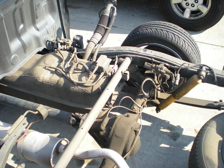

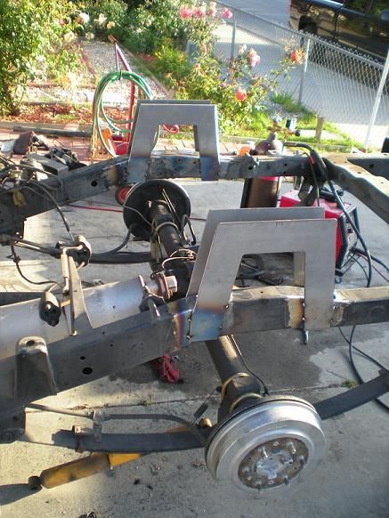

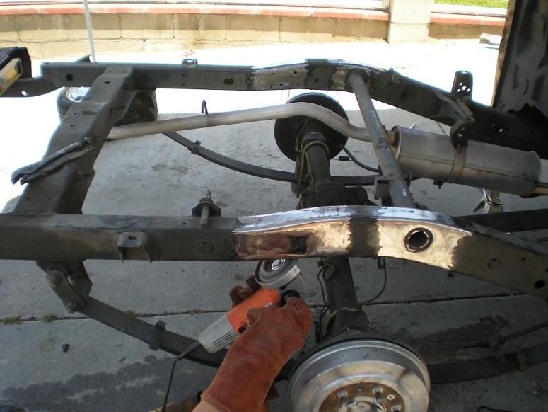

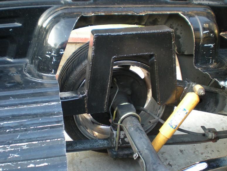

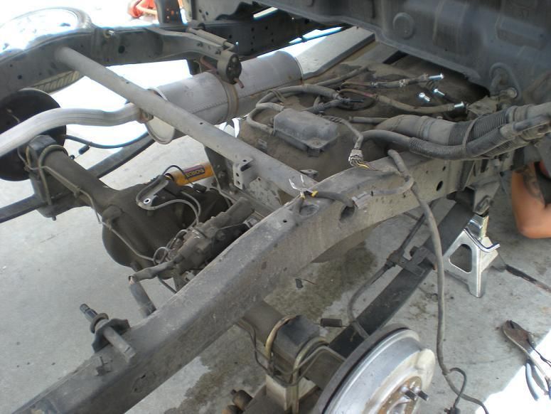

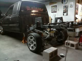

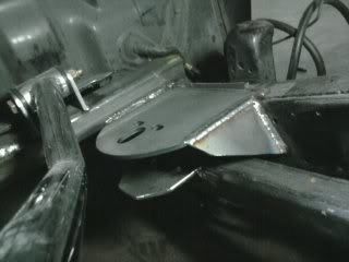

Thanks everything has been done by me and my bro. body drop is next and then on to some massive body work and then paint and interior,,

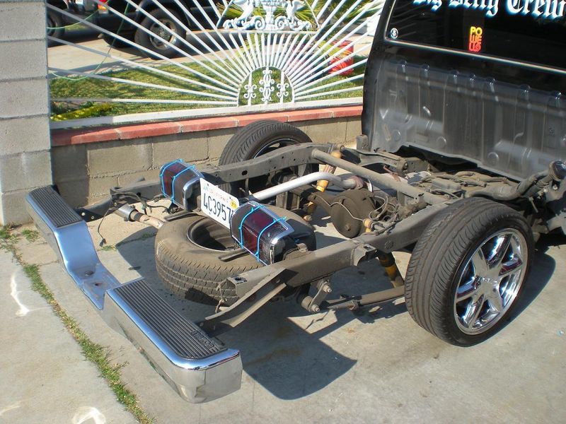

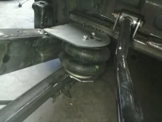

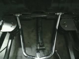

Badass, Twitch! The first pic I saw of the bag on the bar I was like "how much air is thing gonna get" then I saw it. That thing gets UP in the rear, bro. How many people ask you what size cylinders you have?
twitchvoodoo's avatar
twitchvoodoo
haha yea i live in southern califorina so theres lots of lowriders and theres nothing better the rolling up next to a lowrider and lifting my truck and to see the WTF look on their faces hahaha then slam it and roll away.

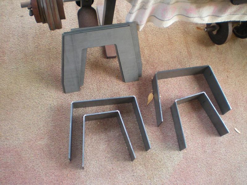

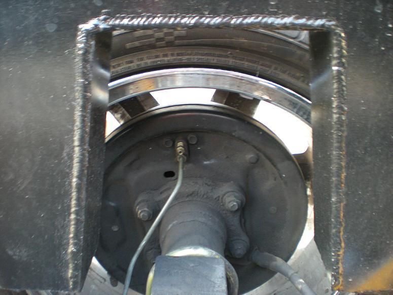

oh and just to clarify the bottom bars were built by me and my bro with 1/4in 2x2 square tubing and 1/4in round tubing and drilled and tapped with a zerk fitting . and they are 4 1/2 feet long to get a smoooooth ride with shit loads of lift and still be able to roll half inch off the ground with 45 psi still in the bag..
