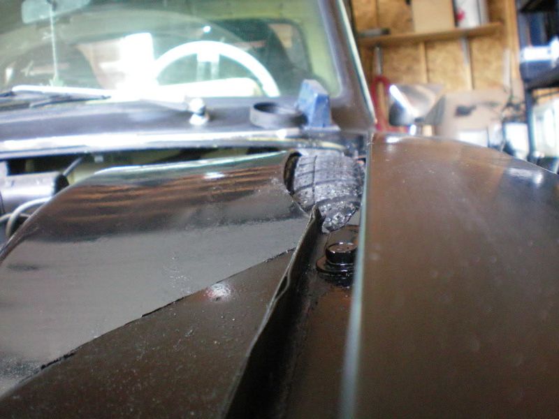

alright we had a long weekend so thats why took a while to get them up...here it is...
hitting booster without tires
pass side stock wheels..
this is the frame measurement

Must be nice to have 20s with a not so big tire. My tire being a 255 makes it 3/4" taller. So there's no way I could rocker my truck on 20s with a 255. I think it came out to be 26.9". The only thing I'm really worried about is the camber I might get, and moving my booster and were I'm going to move it lol.
mercin
yep thats what im up to now...pass side is all set for bag mounts and what not drivers side needs to move booster over for it to clear...tires ill have on the front are 225/35 and rears will be 245/35
