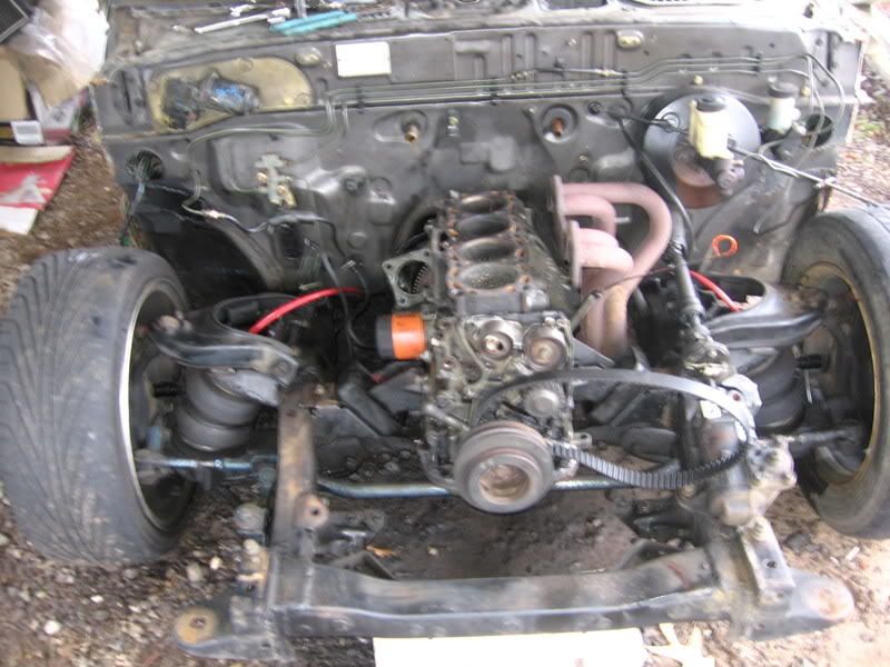

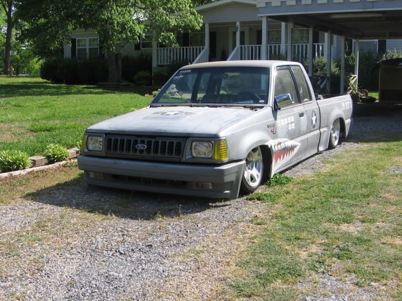

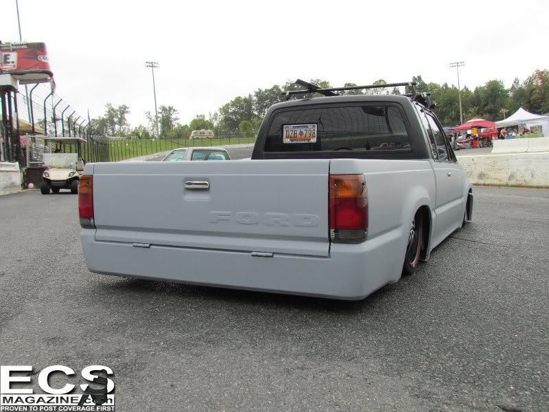

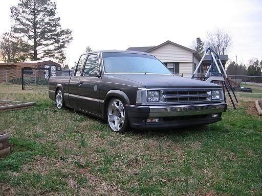

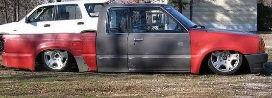

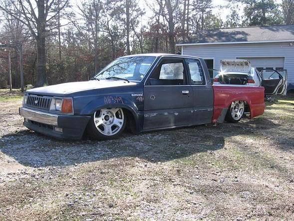

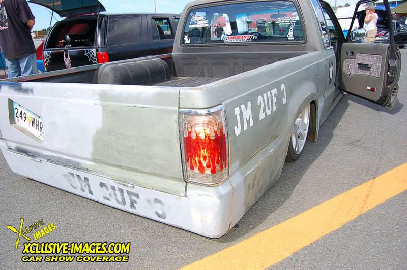

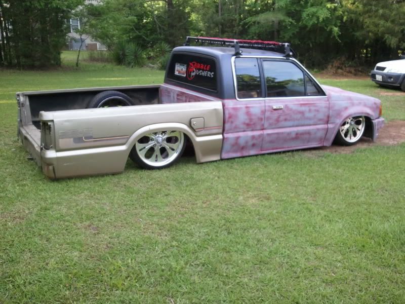

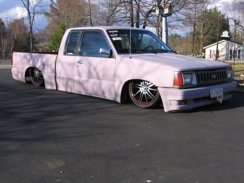

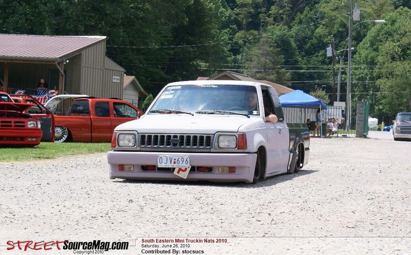

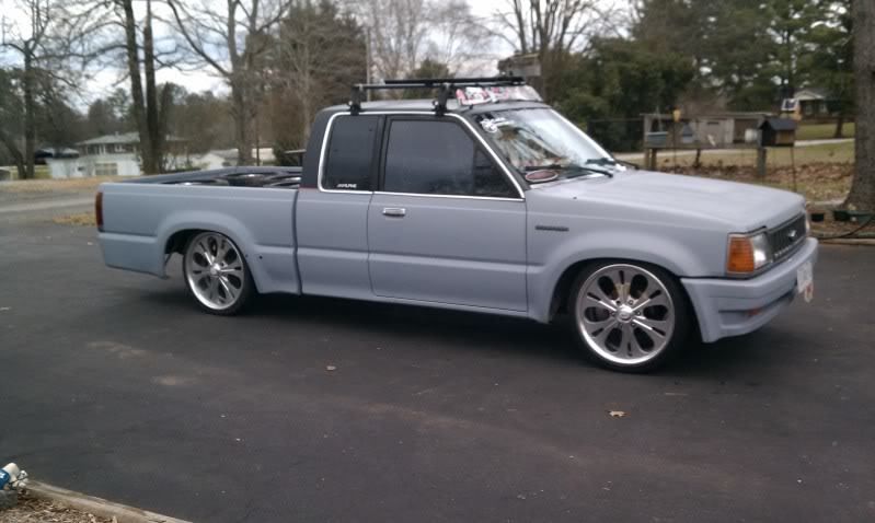

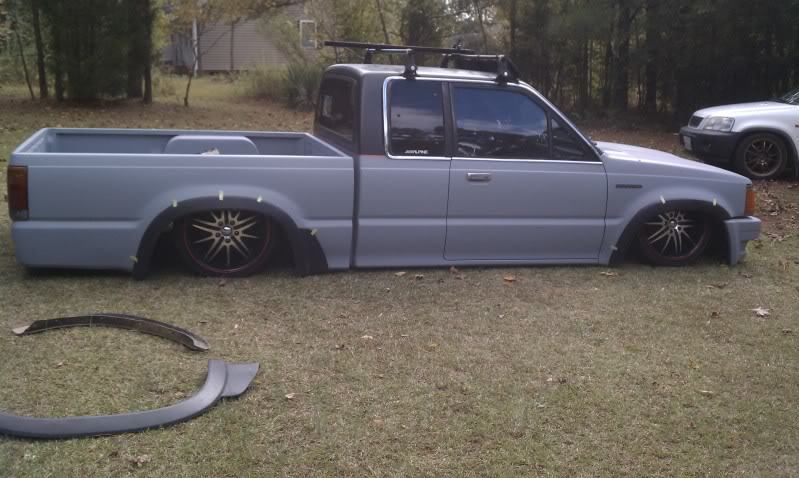

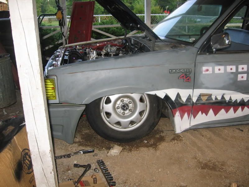

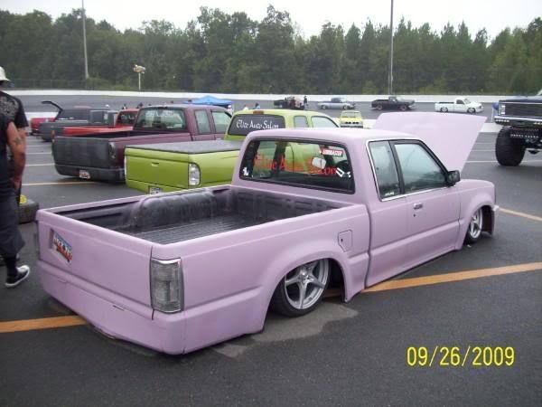

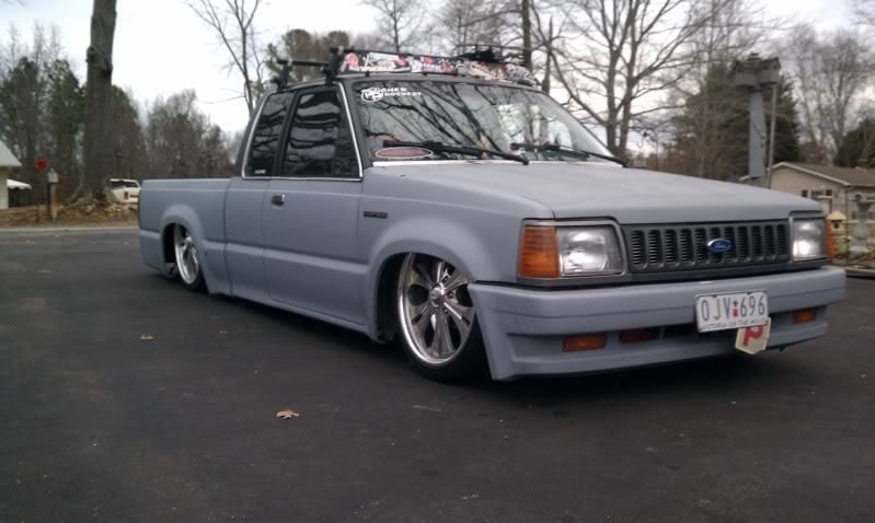

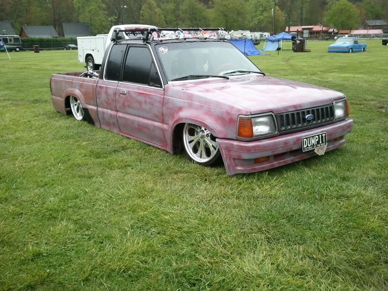

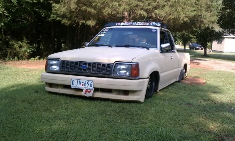

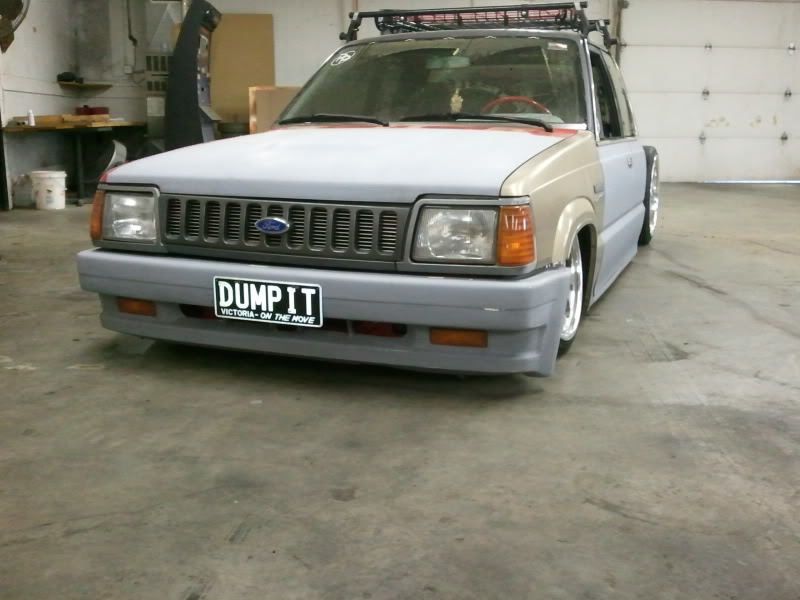

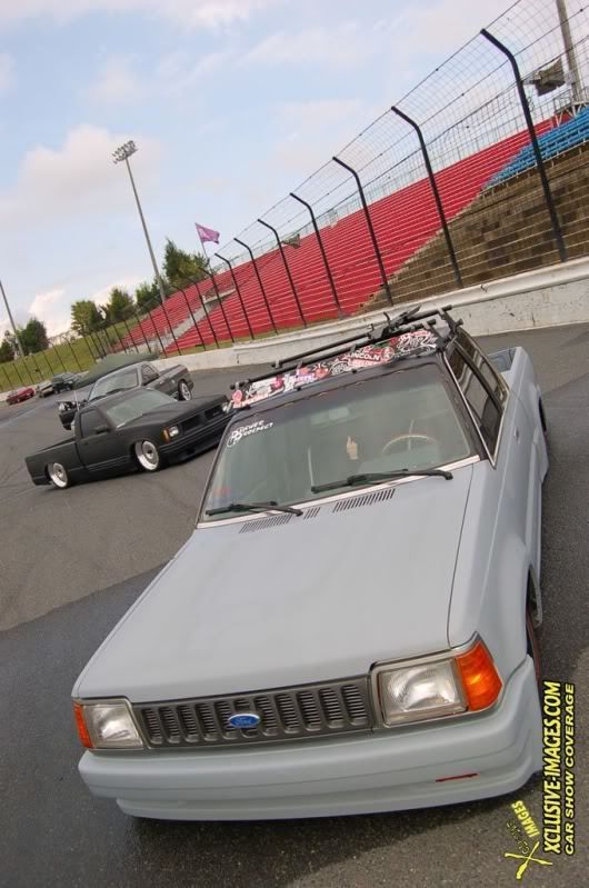

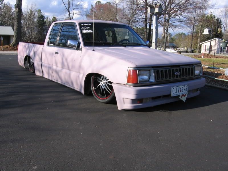

ok guys im finally making a project thread. im tired of having like 9 different posts about my truck. i just wanted one post to come to everytime i do something. heres some pics to get it up to date.

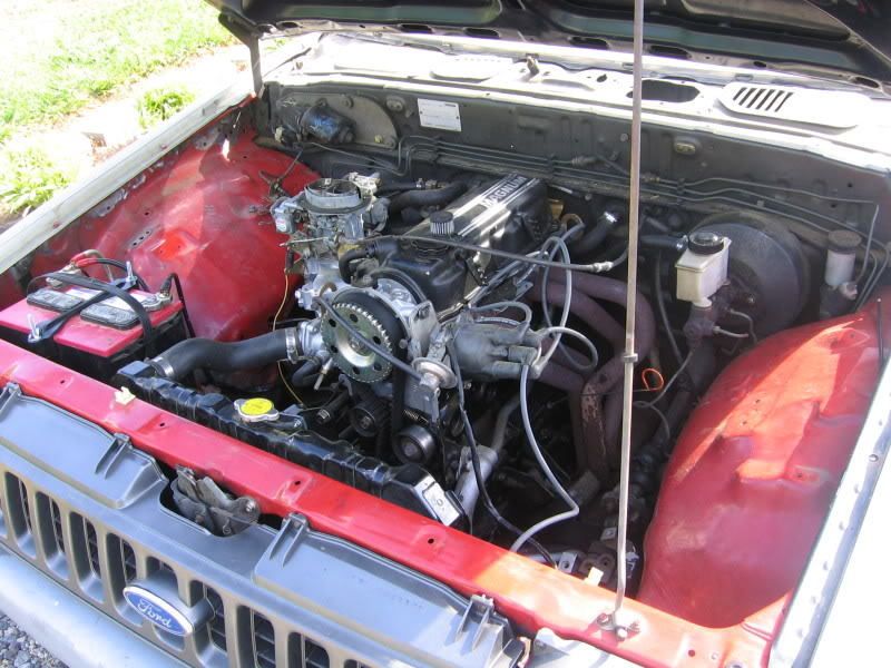

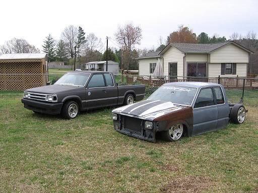

heres how it started, its the one on the left. the one on the right is my old one i parted out

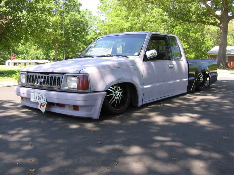

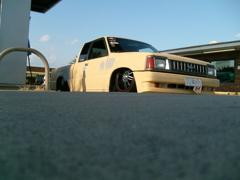

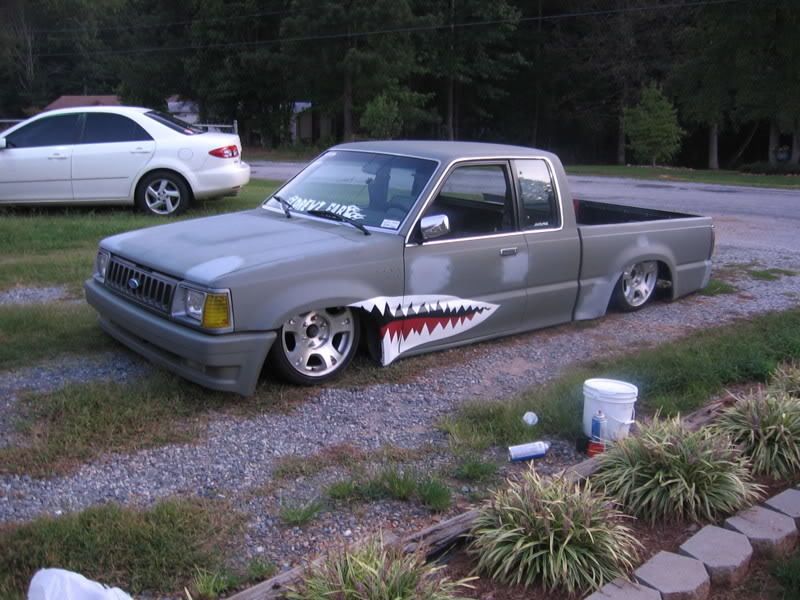

here it was static dropped

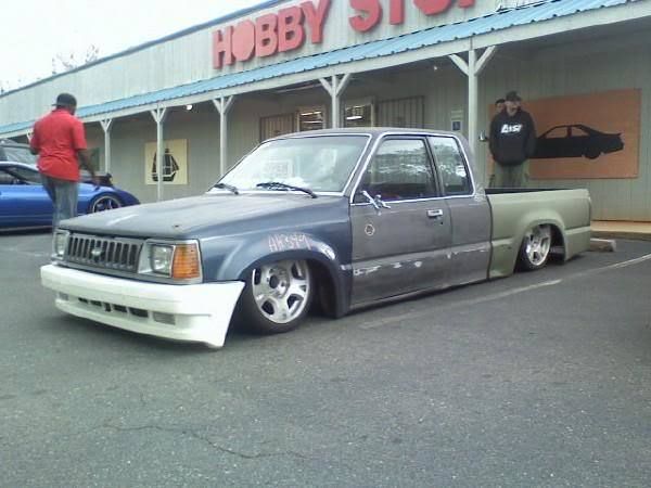

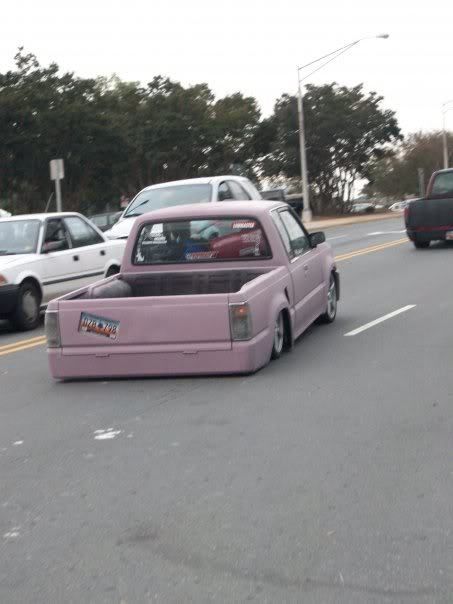

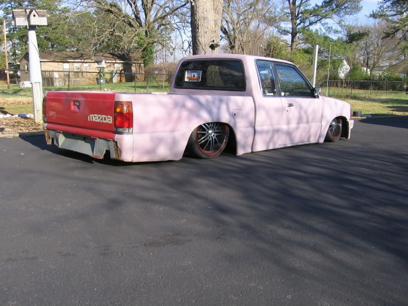

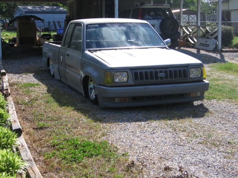

here it is bagged

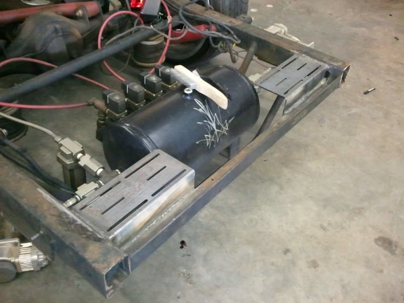

here it is doing work

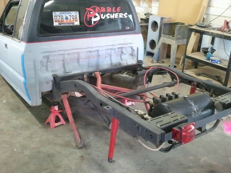

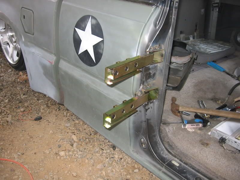

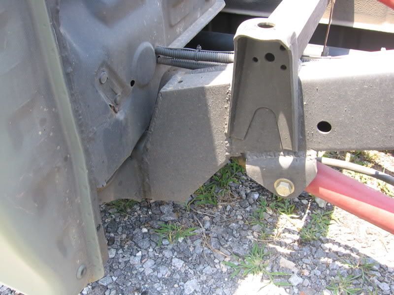

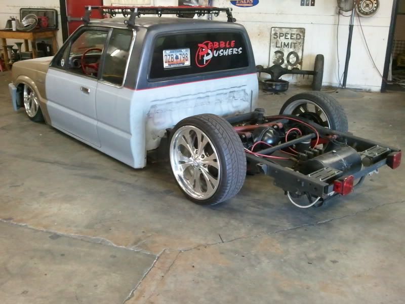

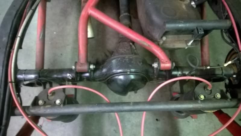

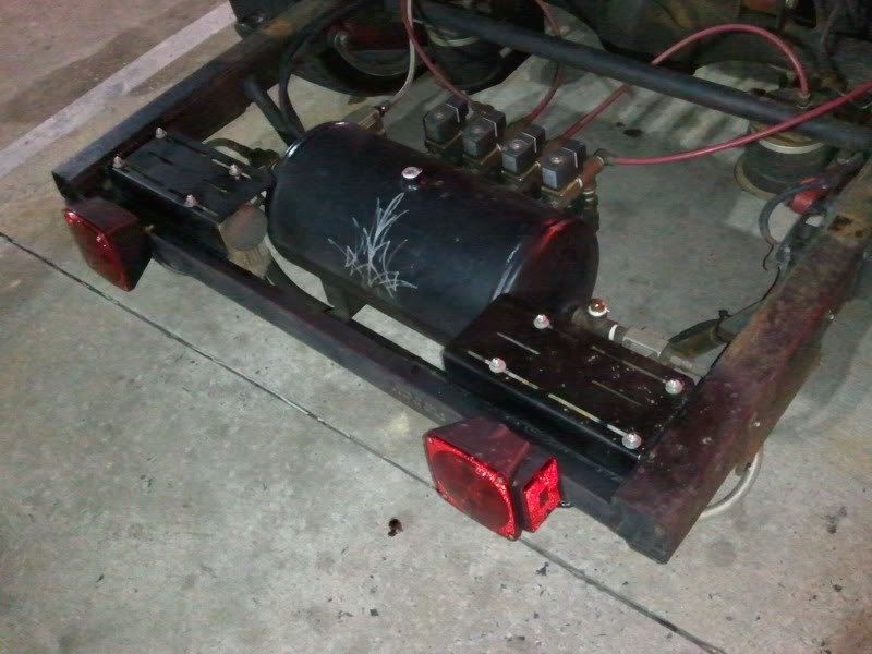

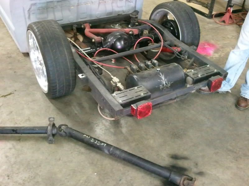

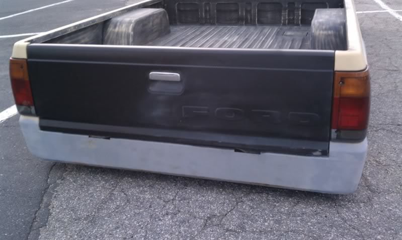

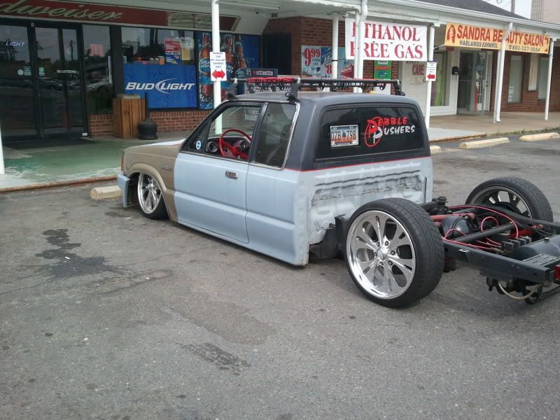

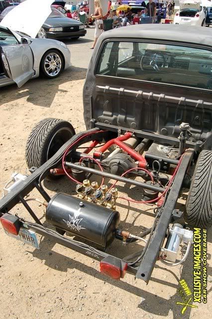

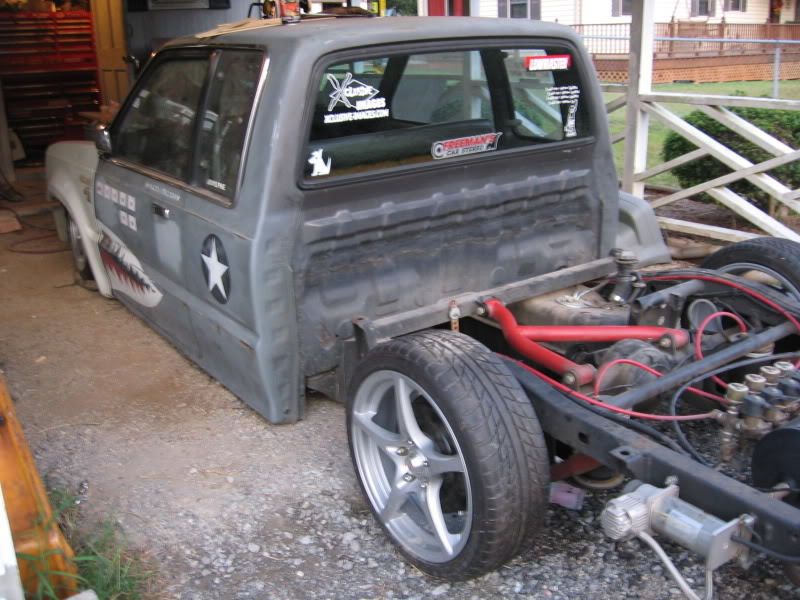

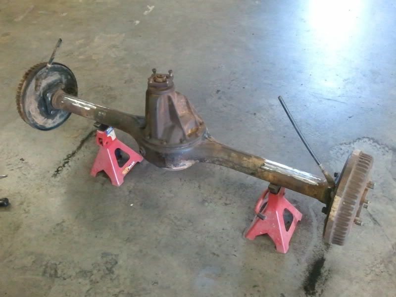

frame z'ed instead of notch

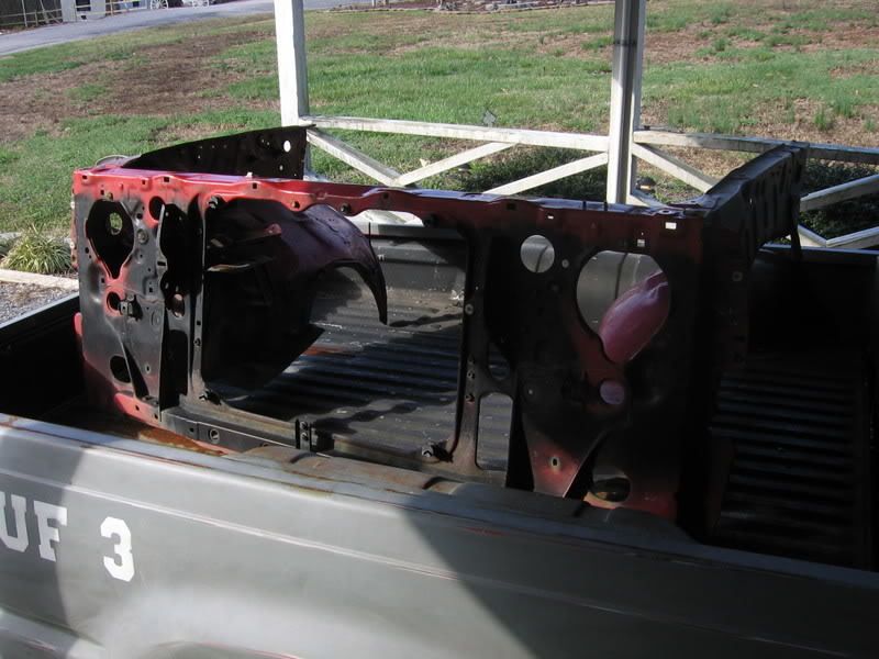

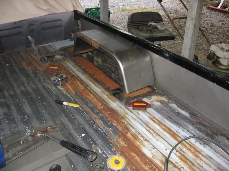

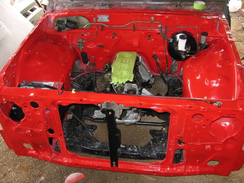

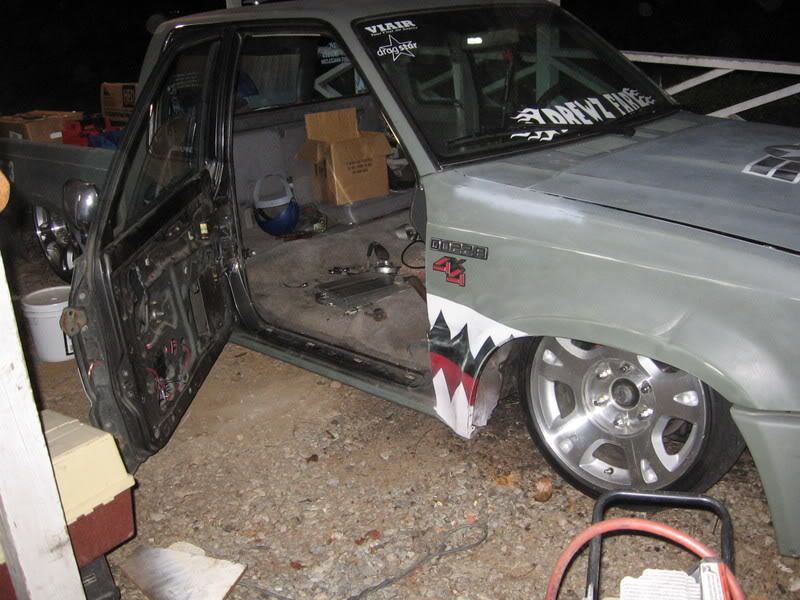

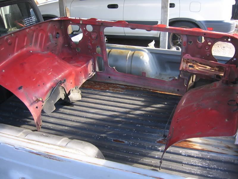

doing the bodydrop

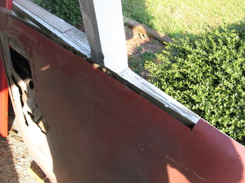

got some 4x4 sheetmetal

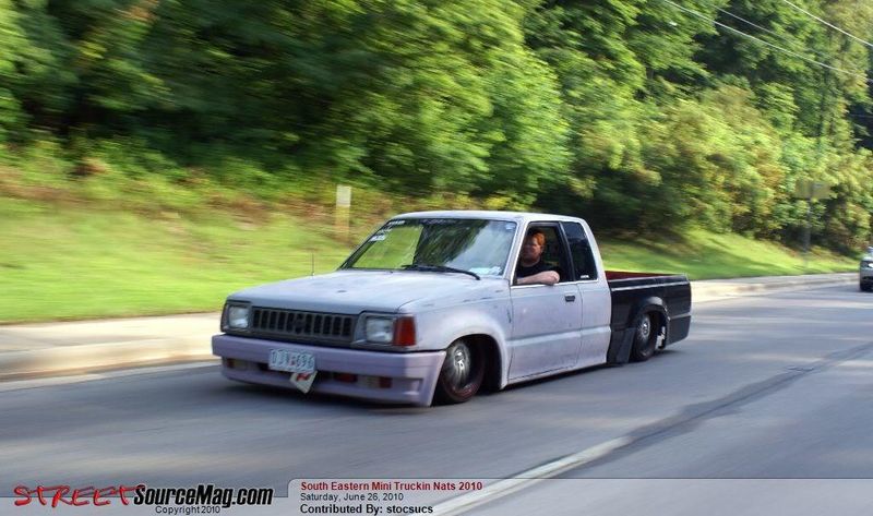

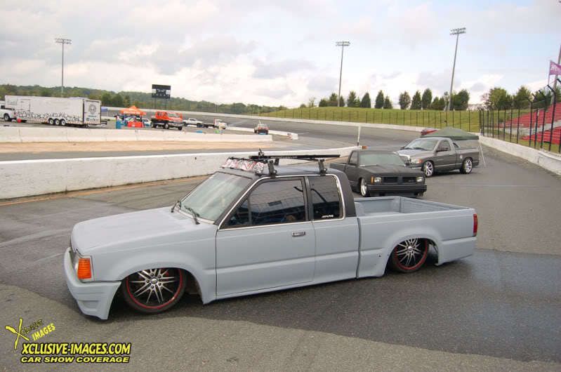

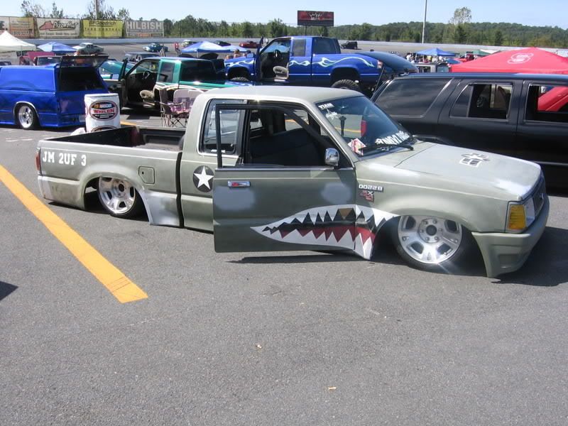

and heres how it sits now

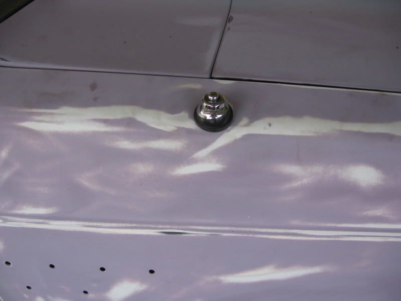

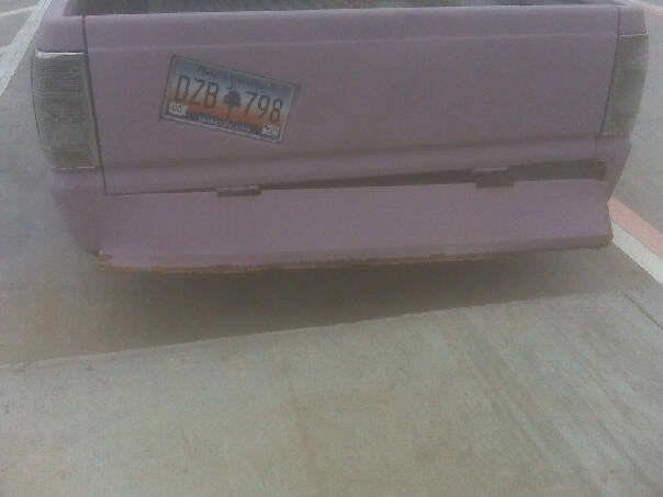

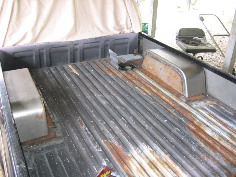

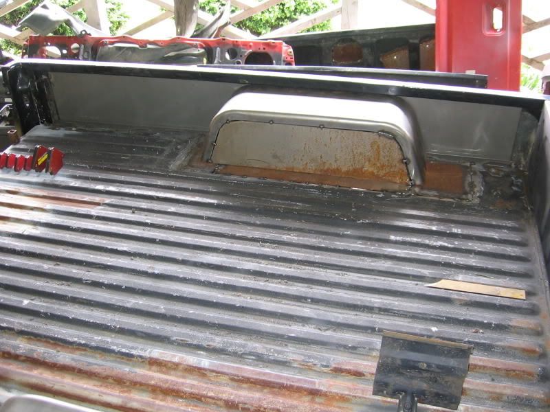

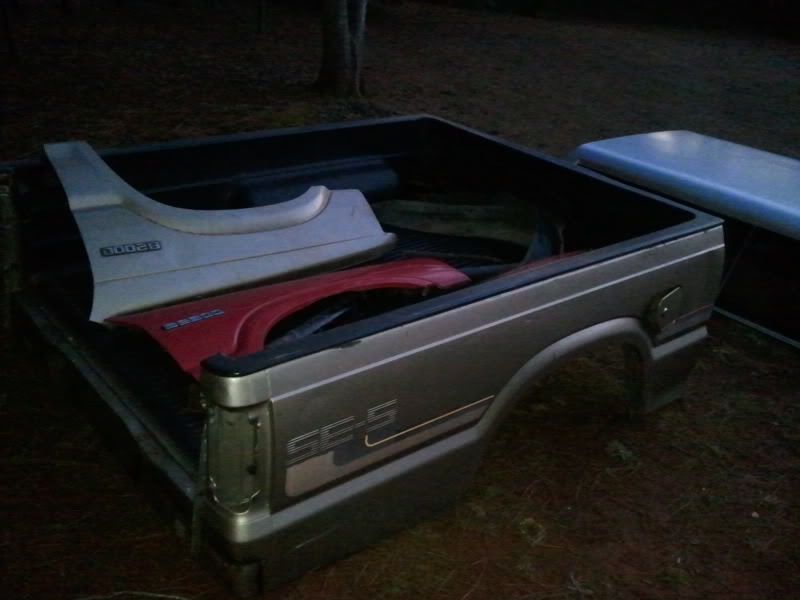

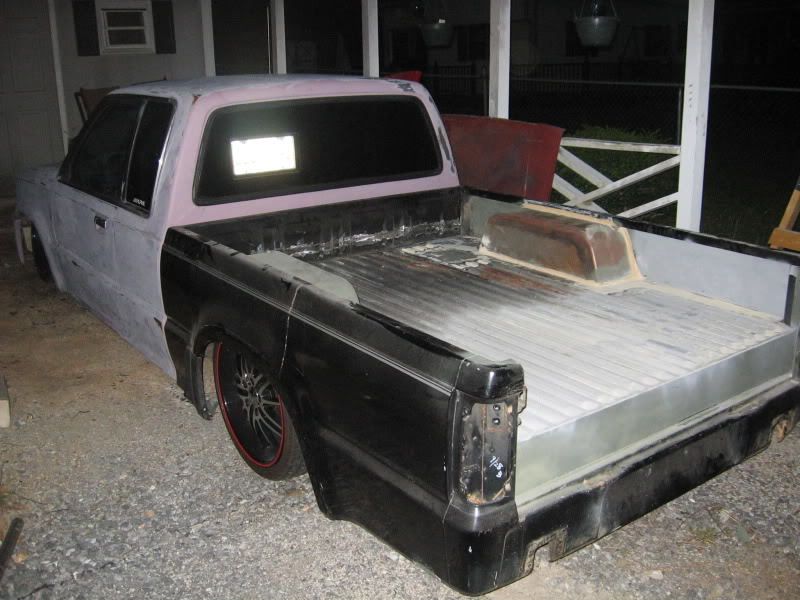

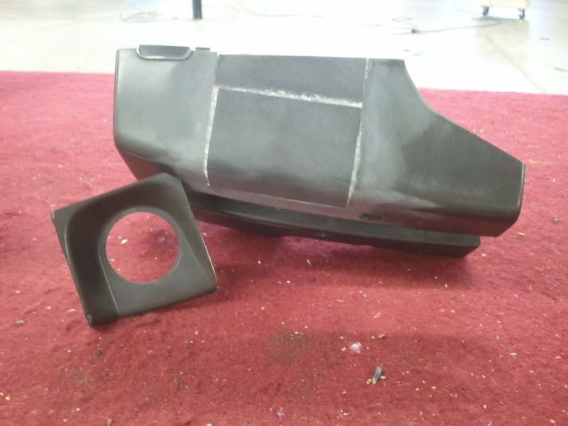

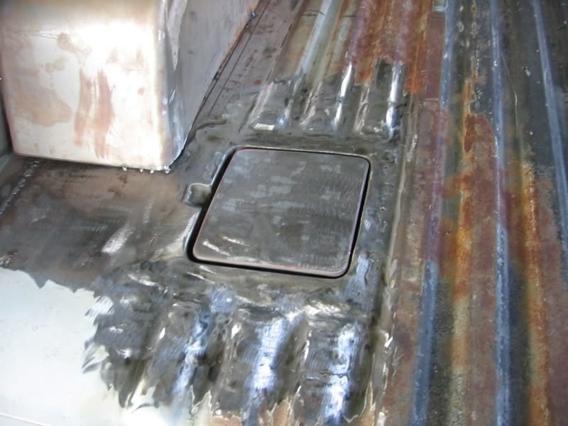

heres what i got done today. i had a square cut out for my gas neck to poke through the bed so i could fill it up. i got a gas door off of an s-10, butchered it up, and put the hinge on that square. i didnt get it finished cause it started raining. heres what i got so far.

the truck looks good man. keep up all the updates. and just have fun doing it. really like the zed frame out back have never seen that done. made me want to do it to mine but i allready cut the crap out of my frame. lol
sleepyspeed's avatar
sleepyspeed
bout time lol!
elbine69's avatar
elbine69
Bout time you had a project thread haha. What was the reasoning behind sectioning the frame rather than just doing a notch?
mazdawg(mikey)'s avatar
mazdawg(mikey)
wanted to keep a stock bed floor and i didnt like the whole spacing the bed up to go over the notches. the floor is more stable this way. and it was cheaper....lol
elbine69's avatar
elbine69
haha way cheaper for sure. def pretty cool though, first time ive seen that done.
crazymikey's avatar
crazymikey
Nice progress and as always,the truck is lookin great!
I too really like the Z'd frame.I don't think I've seen that done on the rear before. How much higher is the Z'd section? Does that still fit under the stock bed floor with no mods to the bed?
mazdawg(mikey)
the rear was sectioned 4 inches. the bed still bolts up factory but it deff needed to be bd'ed. i didnt cut the bed till i got the cab done that way i cut the bed once.
crazymikey's avatar
crazymikey
That's cool. Takes a little more guts to go and Z the back half of the truck,but the end result is much more cleaner than big bulky notches that make it look all hacked up.
I give you props for that!
