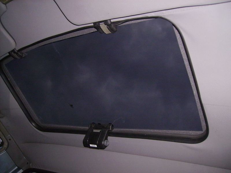

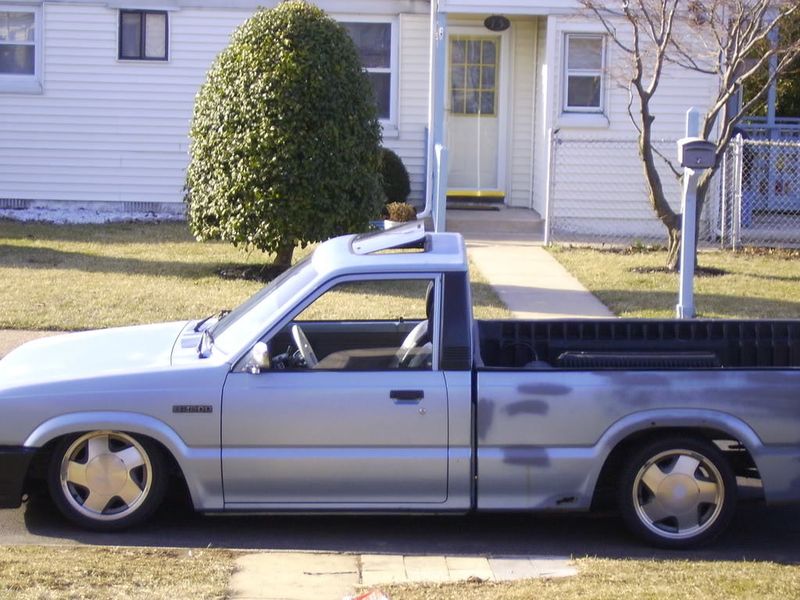

just put the sunroof in out of a 1995 dodge neon. i know alot of after market sunroof's leak but i thought it would look cool.

nice man. how long did it take? and how bad was it?
bgdb26k
looks good man!! hopefully no leaks!!!
3rdtimesacharm
it took about 2 hours most of the time was on the headliner. i sprayed it with a pressure washer and there wasnt any leaks from that so i figure im good, hopefully!!

Got any more pics? Or possibly some in progress ones. It looks pretty good from what I can see.

that looks real nice.
3rdtimesacharm
no i forgot my camera at home when i did it it was easy though i made a cardboard templete for the hole and then centered it on the roof. took the head liner down, and cut it with a cut off wheel and a dremel in the corners for the radius. and i sealed it with permitex.
3rdtimesacharm
ill try to get some pics of the headliner up tomorrow.
looks good ..i want a split side by side sun roof
snoplow
how much insulation is in the top? ive got to do mine yet, and was just wondering. how thick was the top?
