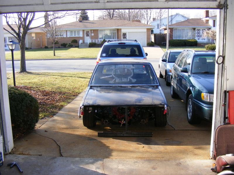

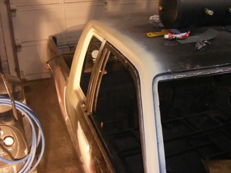

heres the start, one of the earliest pics I have
stockfloored but not traditionaled yet

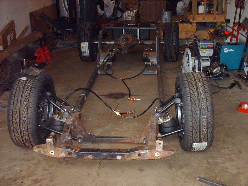

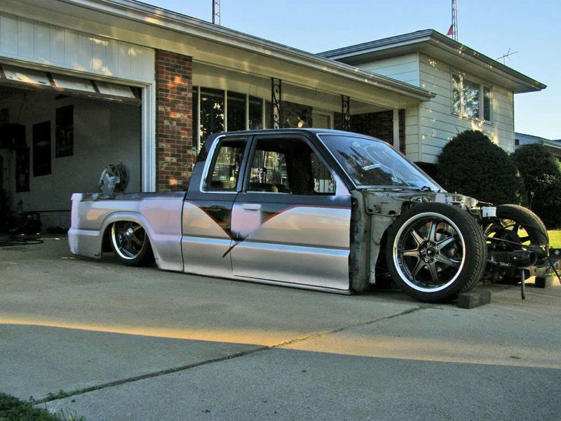

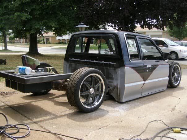

rear setup with fuel cell

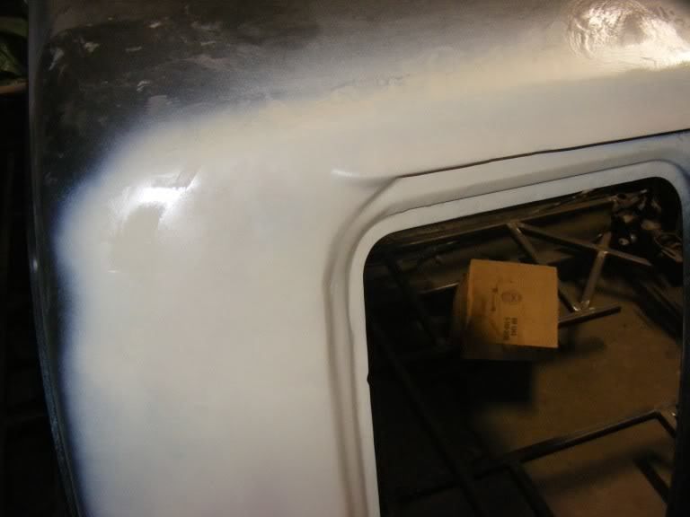

bed thrown on for pics, shortened bed 9" from the back

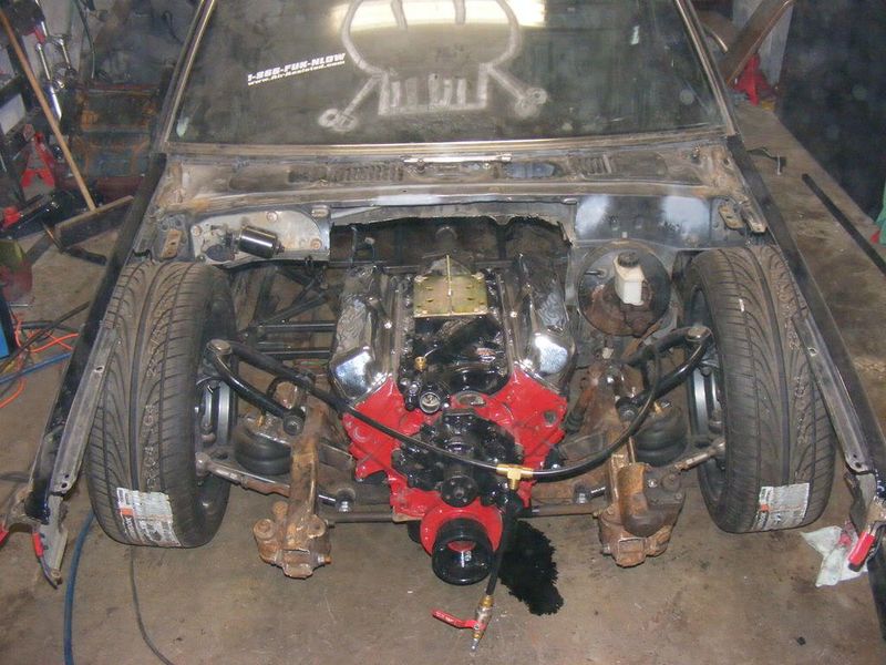

this is stockfloored and traditional bd, laying 1" from doors, and hoping to fit a V8 with as little cowl as possible

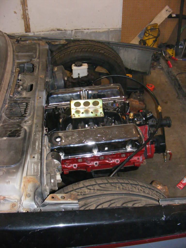

1993 Mustang 5.0 with dual sump oil pan, switched to a carb set up starting to go in
just a little cutting into the firewall

how is it both stock floored and traditional bodydropped??

Thats sweet. How much does that motor stick up above the fender?
scotto79
I stockfloored it with 2x3, then I also raised the new cab floor another 1.5" for a little more exhaust clearance and really, just to get the truck a little lower.
And without the carb on, the motor is actually 3" or so below the top of the tires, so I'm hoping to get away with some sort of a really small cowl depending on the air cleaner.
