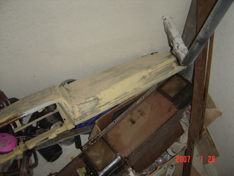

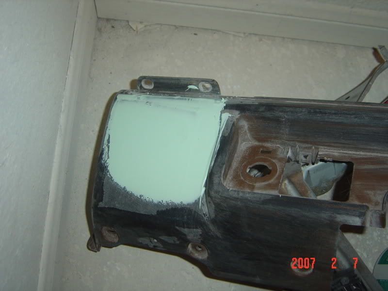

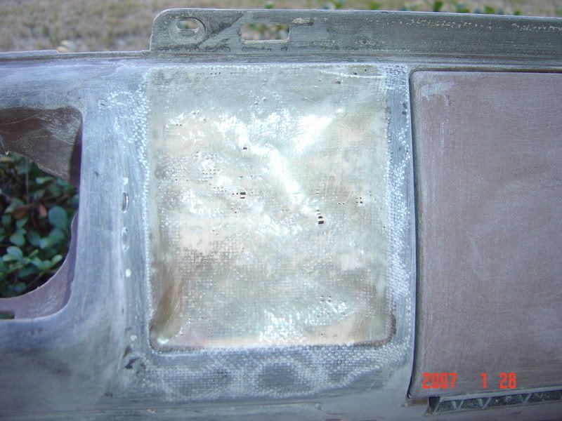

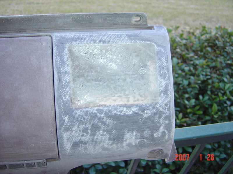

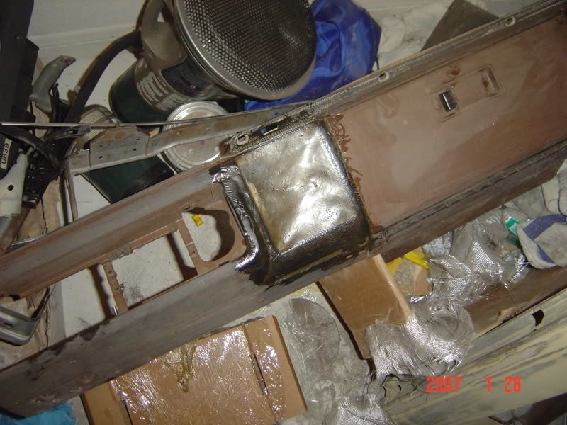

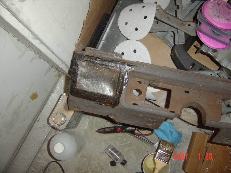

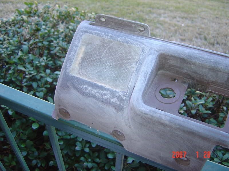

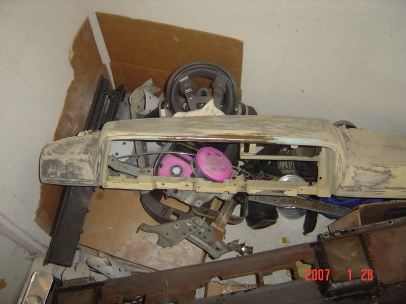

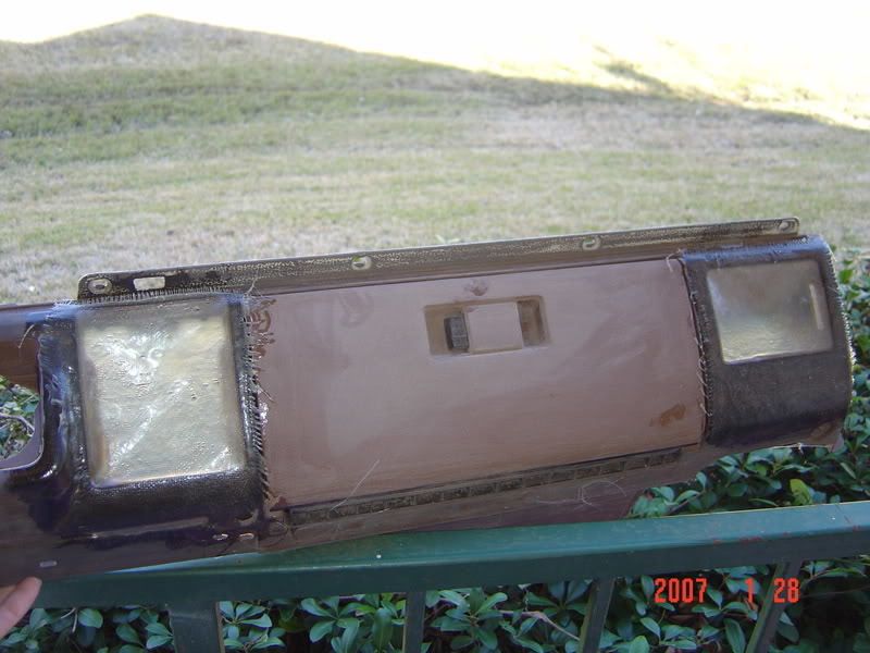

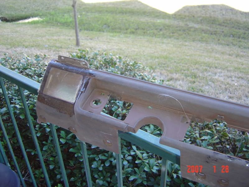

here is what i started on last night in my little closet. haha. started sanding and fiberglassing my dash for the 83. here are the pics...

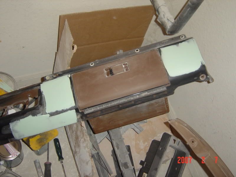

then a lot of sanding got me to this point so that i could lay the fiberglass filler, when it dries i will sand it and take more pics.
i will post up more pics later tonight, when i get further along.

LOOKS GOOD , WILL BE NICE AND SMOOTH WHEN YOUR FINISHED.
DID YOU USE CLOTH OR MATT TO STRENGTHEN IT?
maztang (ryan)'s avatar
maztang (ryan)
i am laying the cloth, then filling it, then sand some more, then matt, sand, then a thin layer of cloth, sand, fill, prime, and paint. actually there is a guy i work with that has a cousin that works in a bodyshop that is going to prime and paint it for me. i think i am going to do the whole dash and interior a jet black, and the outside with a flat black primer with a red pin stripe.

well i sanded the filler tonight and had to add a little more due to air pockets. i am going to let it sit tonight and sand again tomorrow night then add matting and take some more pics. i will add them as i go.

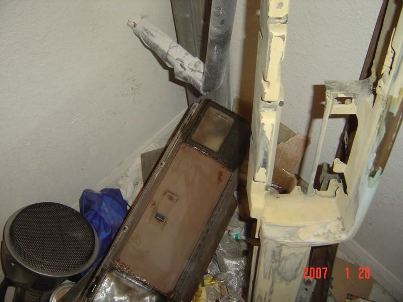

draggin84
man you inspired me to pull the dash out of my 84 today and the wiring behind it looked a lot like yours, did every one hack up the wiring in these things
lost_b2200
Didn't you know it's customary to make a mess out of the wiring before you sell a truck? And you can adapt this to any vehicle you happen to be parting with. lol!
