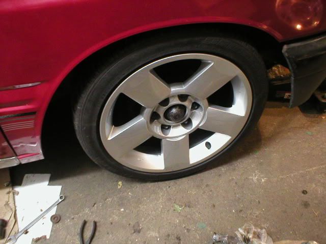

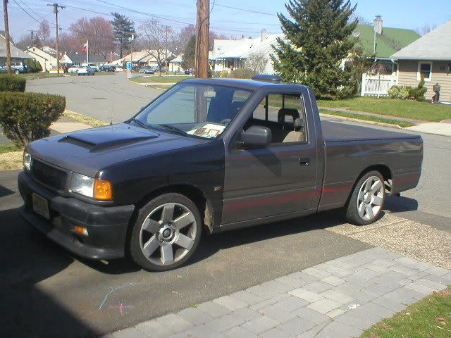

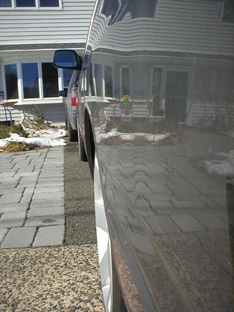

i was running 18x8 titan rims (25mm offset/just shy of 5" backspacing) and also have 18x8 Centerline Archers with 5" backspacing and they JUST tuck on the front with some fender rolling. the backs, plenty of room.
5 spoke Titans on my crewcab FRONT fenders are stock pup/Rodeo
titans on my 94 pup, all stock (NO DROP SPINDLES)
://i83.photobucket.com/albums/j307/lowzone/94%20pup/P2140080.jpg
Rears:
