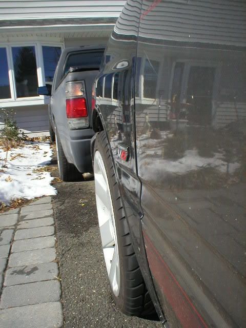

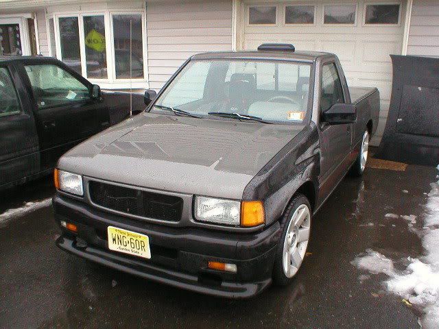

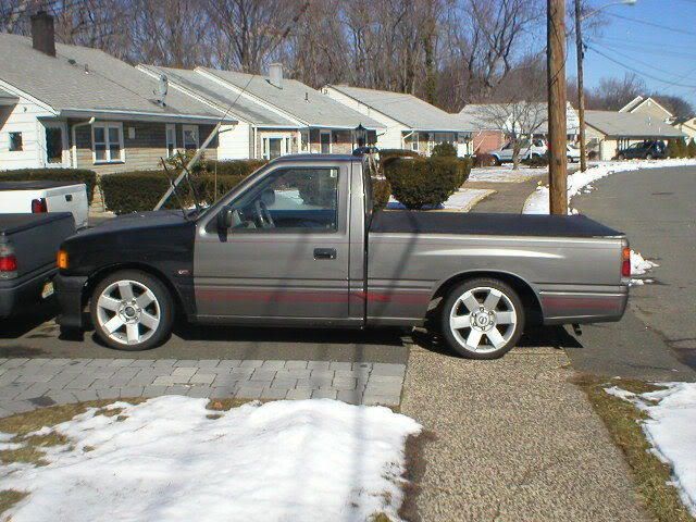

well sort of.....im running a static drop with 4" blocks and cranked torsions, no alignment yet and over 2k miles with no abnormal tire wear. Ive run drop spindles, beside them throwing the front track out about an inch wider, you HAVE to get an alignment right away, otherwise you will kill your tires. As everyone said, a cranked torsion bar front end drop will give you negative camber (maybe alittle toe issue), but spindles will throw the toe out alot more as well. Being on a high school/truck payment/part time job funding, crank the t-bars and get an alignment as soon as possible but it will be drivable for abit. heres mine with a 4" drop...the front has to go lower i know:
I
isuzueh
man that almost looks as if you have some positive camber going on there haha
lowzone1
yeah right, its just the angle of the camera and my driveway. just for a personal note.... DONT BUY WANLI TIRES...OMG, the noise, make it stop....please GOD make the tire noise stop....whirrr whirrrr whirrrr whirrrr whirrrrr.....but hey they were 55.00 each
