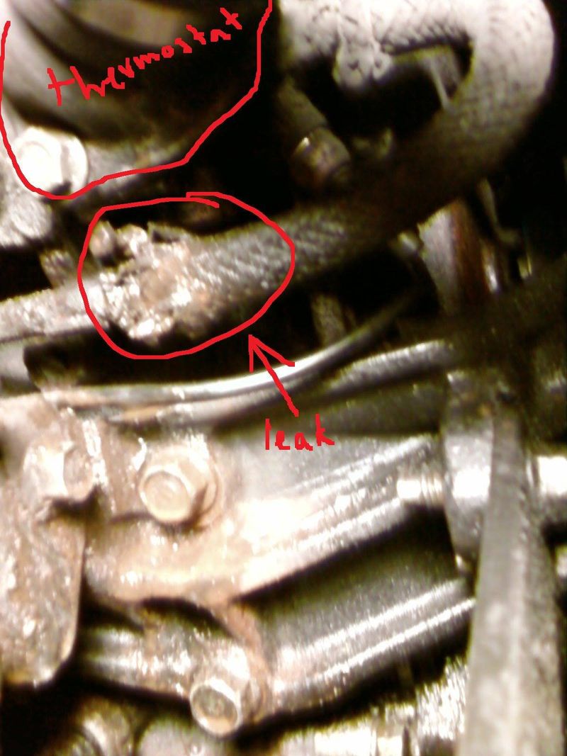

i just changed the thermostat a couple weeks ago. i forgot the gasket and i changed that yesterday. and ya i meant the water temp. theres a little hose under the thermostat that is leaking. i'll have a pic in a couple mins
effdbmx1's avatar
effdbmx1
heres the picture:

That's called the bypass hose (the "J" shaped hose); I had to replace mine once. However, mine was molded solid rubber, not braided like yours. See AutoZone
