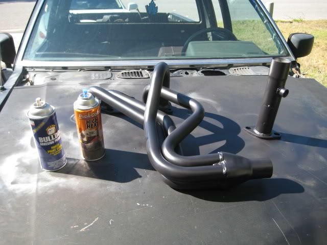

Just a pic of how Im going to run my exhasut until I can get some new pipe and what not (my old exhaust had rust holes in the pipes and bolts wouldnt come out at all)
