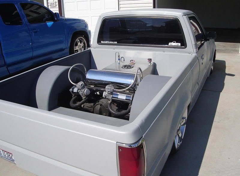

I bought mine from Summit...its a 15 gallon aluminum with a GM sender
Its super easy to plumb it to your stock setup, the only problem you will have is the sending unit. I have after market gauges so my fuel level gauge is for a GM sending unit. But if you are keeping your stock gauges you'll need to find on that is close to the same ohm range...I think you can use a GM unit, but it will read backwards on your gauge (Empty=Full vise versa)
They are 2 lines involved. Feed and Return. You'll have a third line that runs to the charcoal canister,but its just for emissions venting. So you will have to cap one bung and the other is a roll over vent that you can just slap a breather filter on.
I plumbed mine with hardline, but you can use rubber and braided. You will be using AN Fittings which can be confusing, but if I were you I would try and get a fuel cell that has -6AN which is the equivalent to 3/8" which is plenty big enough. Make sure you put a return fuel filter inline somewhere as well as the stock fuel filter.

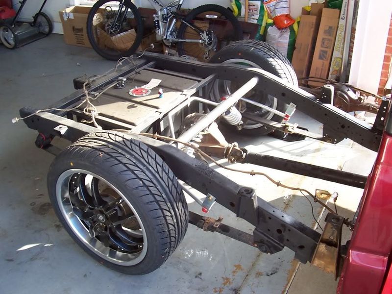

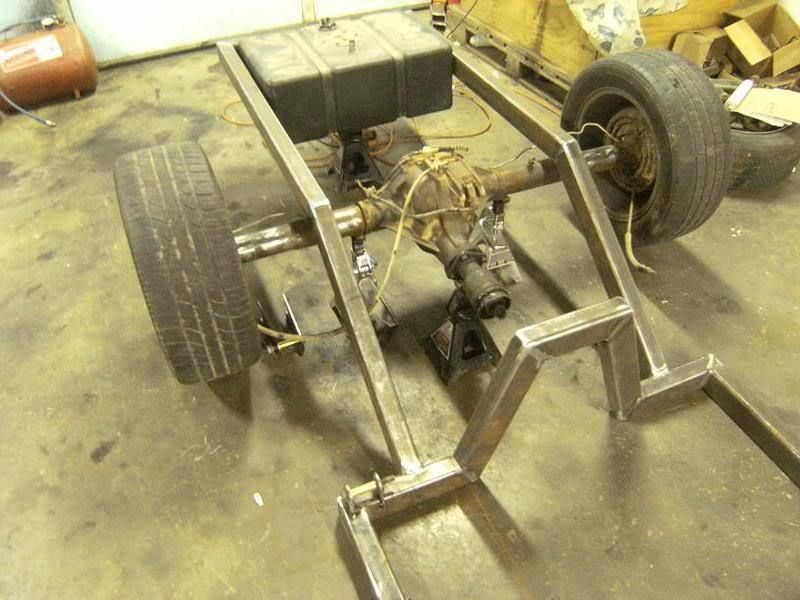

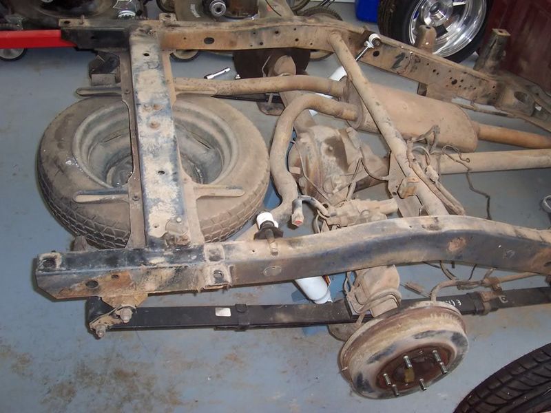

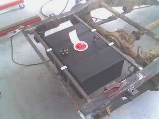

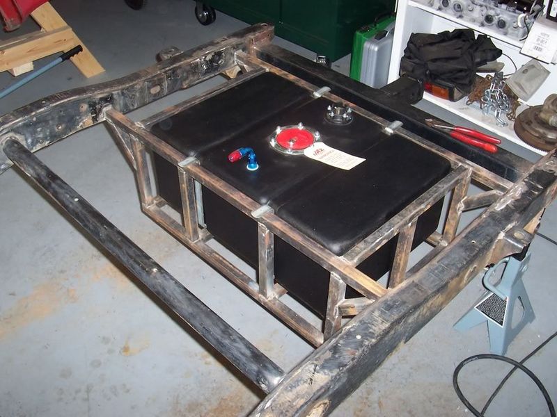

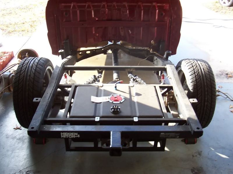

Those are pictures of mine...
Hope this helps...
Dev

hambandit
ssshhhh.....
havent posted pics of this yet.
but heres the fuel cell
