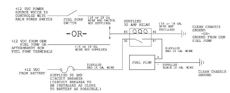

on the fuel pump, you'll need to know what psi the stock 626 ran at, then choose a pump accordingly, easiest thing to do would be to install an elect fuel pump, wiring isn't too hard, and a couple of example diagrams can be found on the pdf's for these aeromotive pumps
not too hard to wire, a relay kit from jegs is @ $40 bucks & makes life a lot easier...

here is a basic wiring diagram for an elect fuel pump
all you do is run a fused wire off the battery to one leg of the relay, off the switched side of that leg to the fuel pump, also you'll have a switched 12v source from the trucks ignition, this is what pulls the relay in, and closes the switched side of the pumps power....ground the relay & the pump, and your in business!
