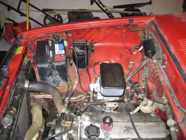

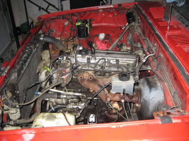

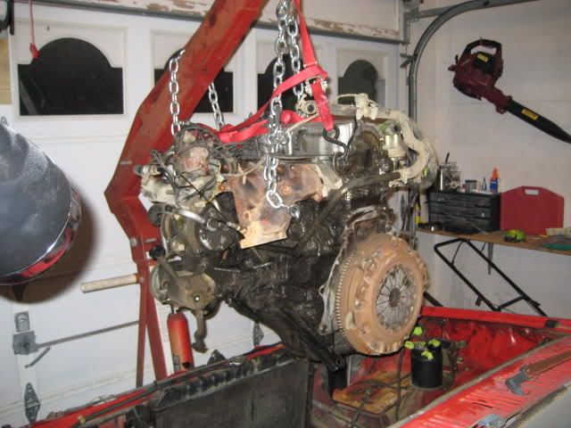

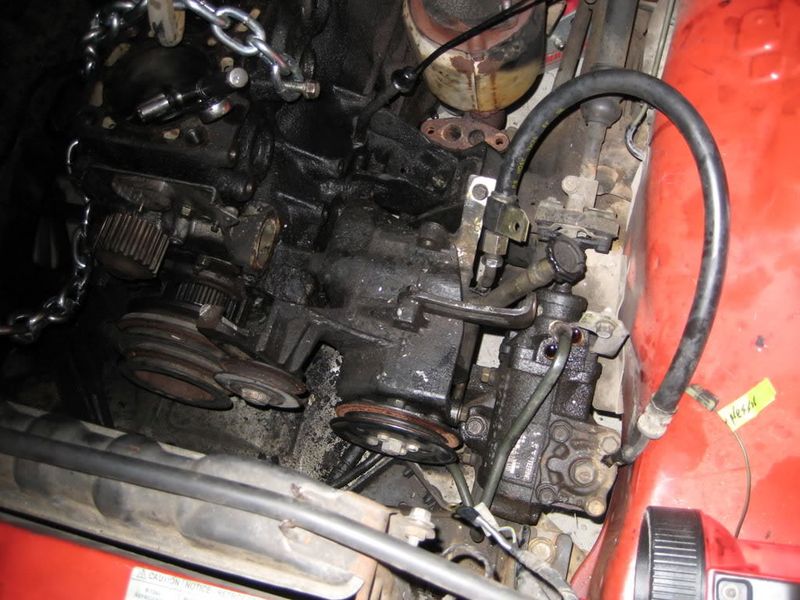

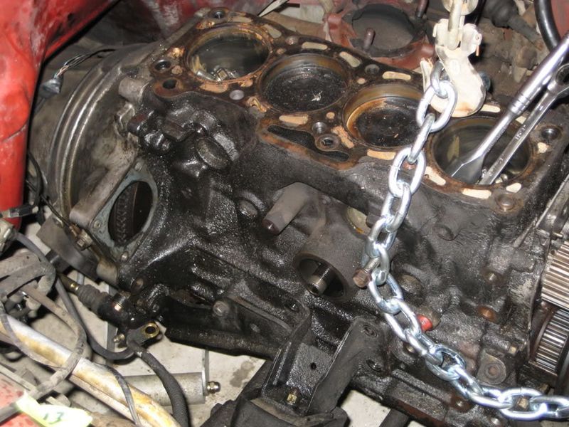

Pulling out old:

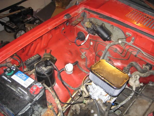

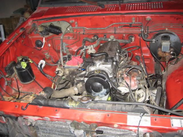

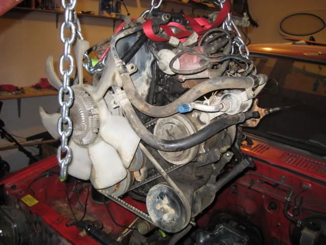

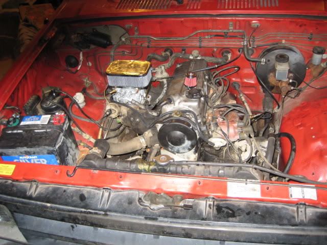

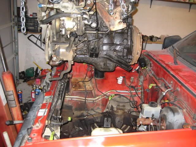

Trying to put in new:

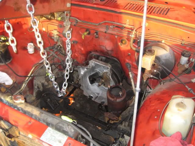

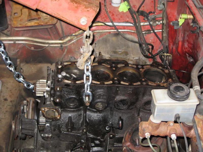

clean bell housing:

dirtracer14's avatar
dirtracer14
If i remember there were a few bolts on the bellhousing and diff size ones they are not all the same. If you are not pulling the trans then jam a screwdriver between the block and bellhousing also i think there are a few small ones on the bottom of the bellhousing for the inspection cover.
nytrdr24's avatar
nytrdr24
I ran into something similar when I was pullin my engine, there is a small screw on the bottom of the bellhousing that holds the spacer inbetween it & the engine, if you don't remove it, the two won't come apart....
dirtracer14
Did you pull the clutch off? if so did you use the alignment tool to re bolt it? Also what i do is put the truck in gear once you have the shaft into it and when its real close then rock the truck in gear and it will turn the inputshaft to help line it up. Make sure the motor is the same angle as the trans.
1dayiwill's avatar
1dayiwill
angle is hard to find and easy to lose, didnt replace clutch. its in gear but ima go try with it out of gear.
southernrazed
lave it in like 4th or 5th and have someone shake the wheels back and forth at your slipping in the shaft..it will eventualy line up

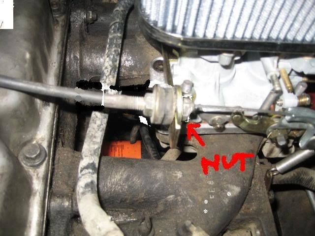

need more help fellas
dirtracer14
Does it have electric choke? If so it needs power to open it? Also look at the bottom of the car are the butterfiles opening all the way?
