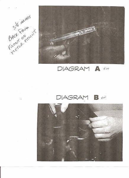

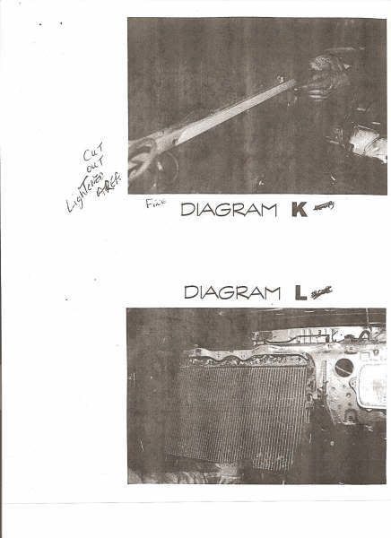

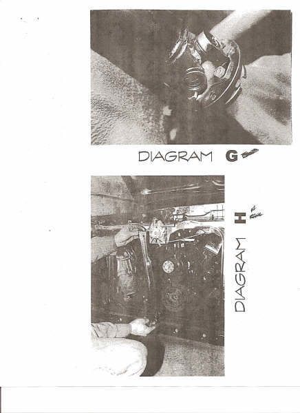

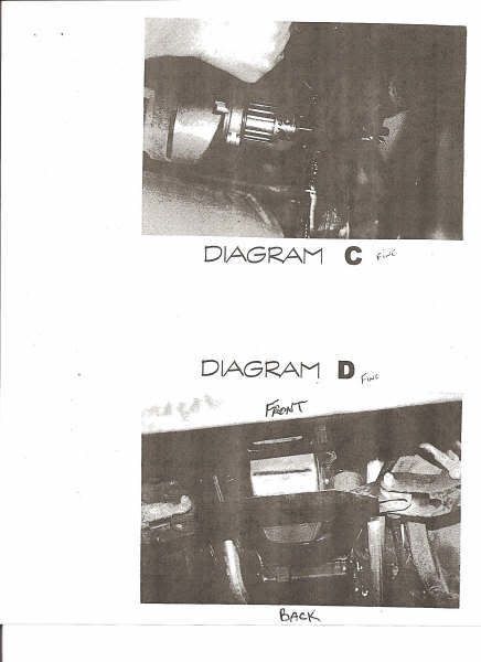

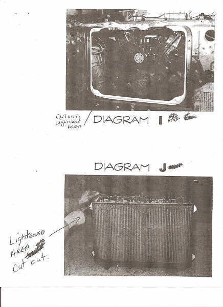

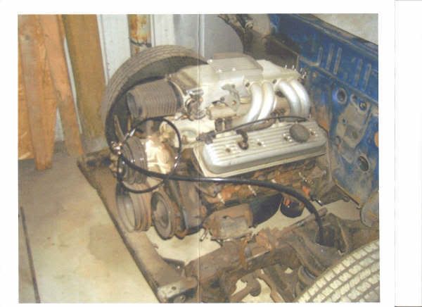

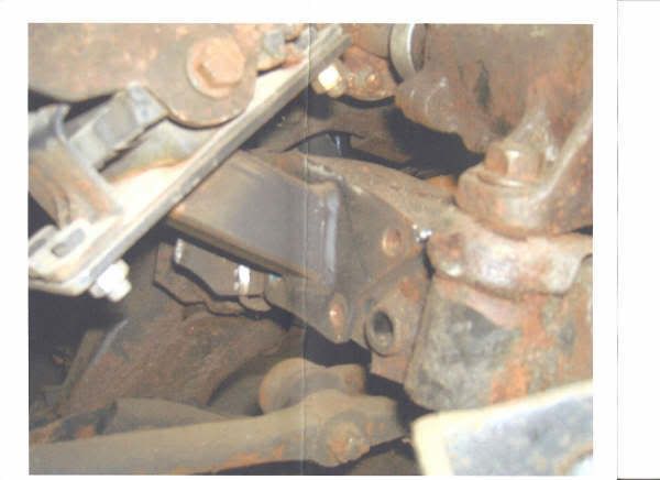

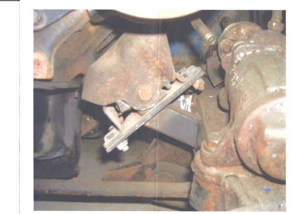

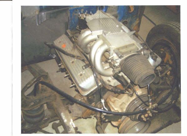

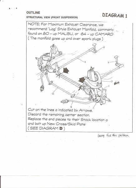

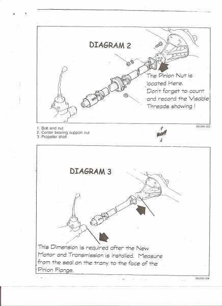

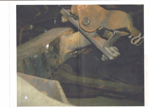

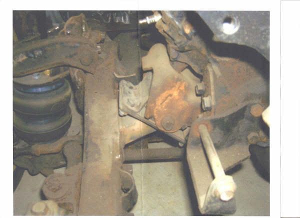

Got these from sudkrap awhile ago and figured they would be a good thing to have on here since theres always quite a few questions about v8 swaps.
Maybe this should be a sticky?
V
v8mazda4ever

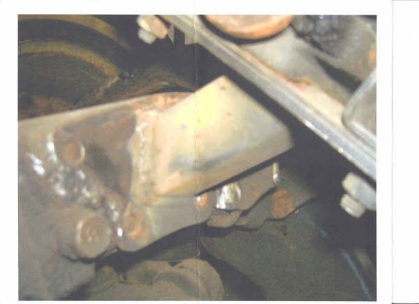

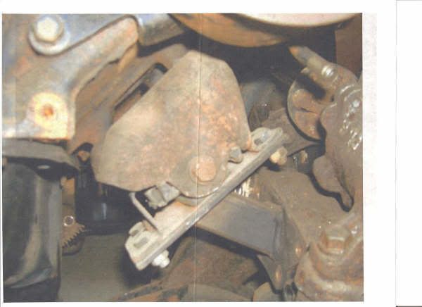

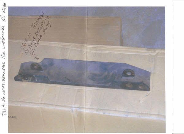

ya that is from me I sent it to sudkrap awhile ago and the picks are the ones of my truck. I do build the motor mounts and the trannycross member.
