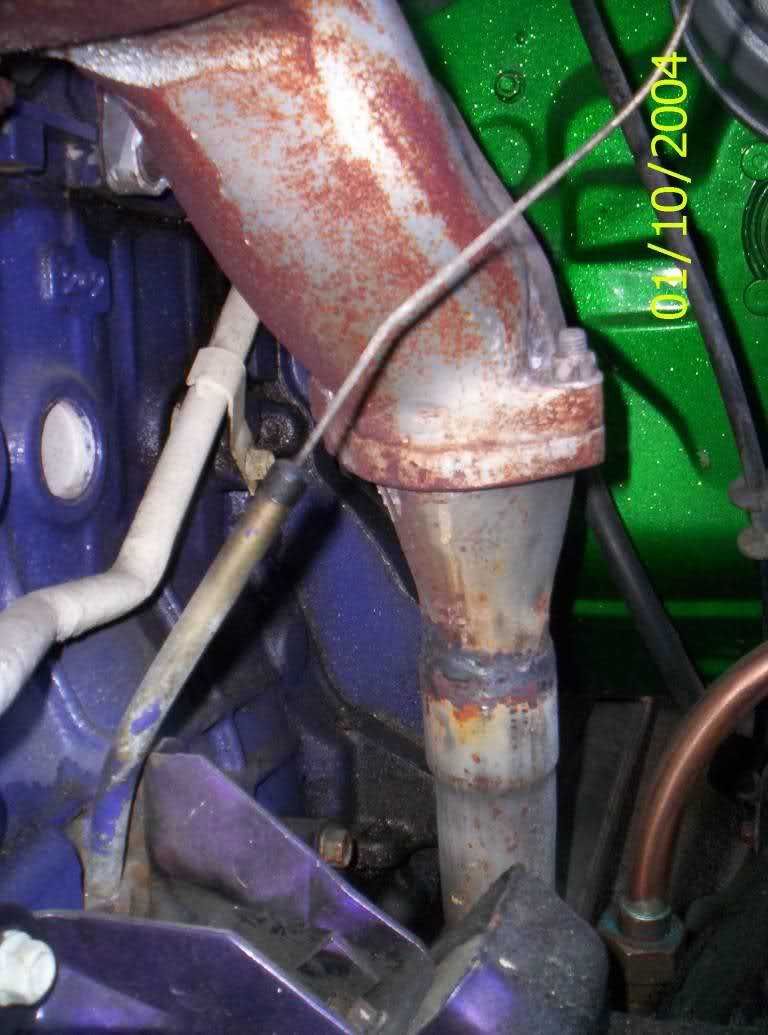

As BJ said, keep heat shield. These pics may help
