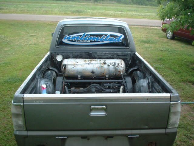

PB
pimp b2200
here ya go
mazdachick's avatar
mazdachick
Dont you need a water trap on it and an oiler too?
PB
pimp b2200
water trap yes, oiler depends on what kinda of compressor you have.Sanden you need an oiler, wich are stock a/c compressors for the truck and some if not all yorks you put oil in the compressor
