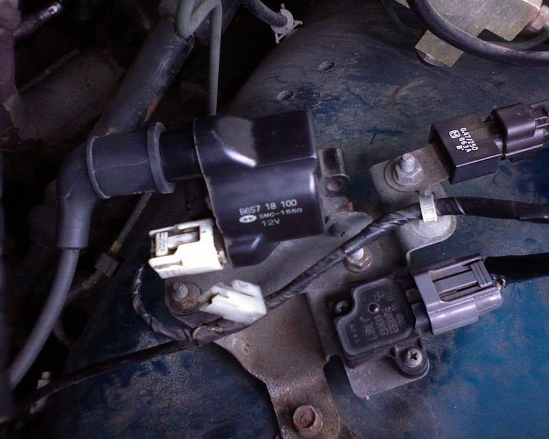

on the coil there is a plug with two wires. I am assuming that one is the power wire and the other is ground cause with the key on I get the 12v on one but i dont have continuity to ground on the other. But with the key off the same wire that had the 12v now has continuity to ground. This doesnt seem right to me

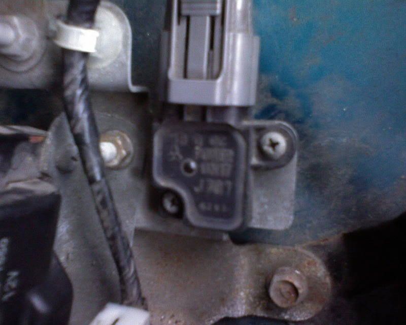

ok i was lookin things over by the coil and i was just wondering what this thing with the gray plug was. I was looking at a wiring diagram and someone suggested that the ignitor might be the problem and i thought this might be it but not to sure.
