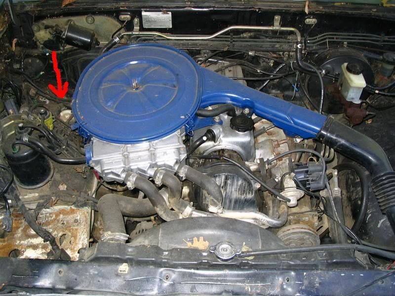

only one filter on these and thats on the firewall correct????
sounds like a fuel filter there is only one
or a fuel pump going bad or something in the tank clogging the feed line...thats what happened to mine the cardboard piece from some fuel additive lid was in the tank
hocbj23
On 2200 carbed trucks the fuel filter is located on the frame rail passenger side right over the tank.On 2200 and 2600 injected trucks the filter is located on the firewall passenger side.BJ

on my 2200 carb my fuel filter is on the passenger side fenderwell in a lil metal clip...
hocbj23
Thats strange.Mr. Mazda must have decided that he could keep us all on our toes by putting them in different places.Mine is in the back over the tank.Lol.BJ
